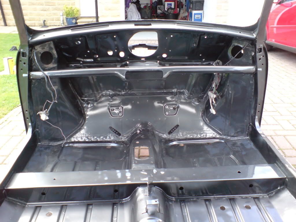

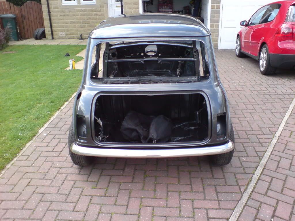

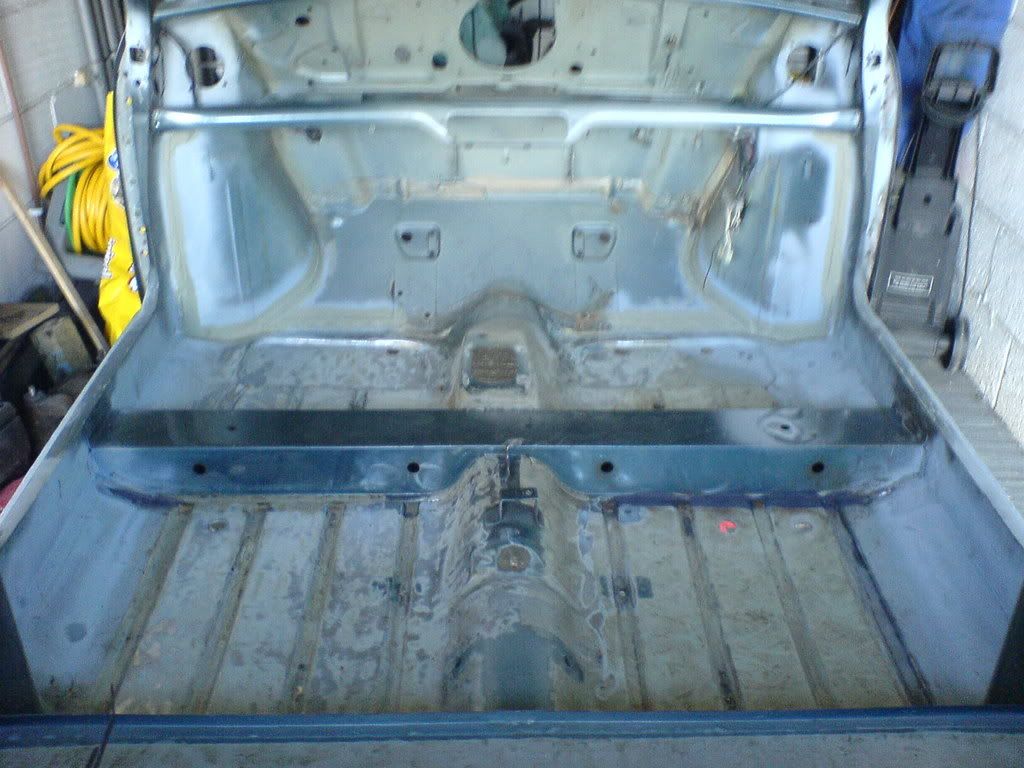

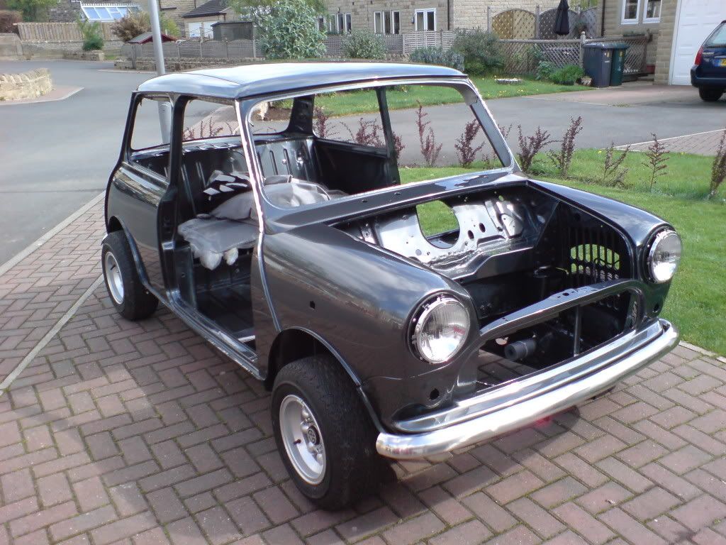

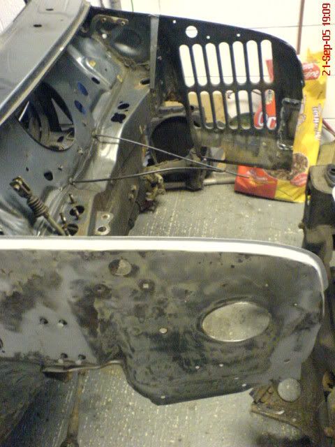

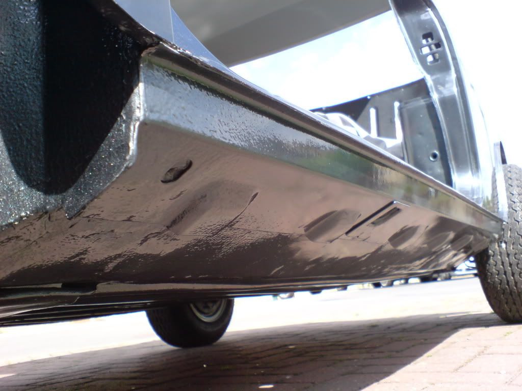

Heres some pics of my mini.
Its only taken 2yrs so far...!
Before
http://i169.photobucket.com/albums/u210/sp...on/DSC00615.jpg
After
http://i169.photobucket.com/albums/u210/sp...on/DSC00212.jpg
Before
http://i169.photobucket.com/albums/u210/sp...on/DSC00275.jpg
After
http://i169.photobucket.com/albums/u210/sp...on/DSC00206.jpg
You get the idea.

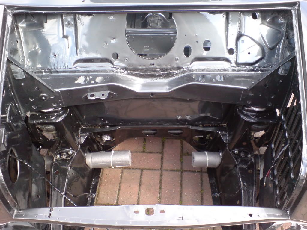

http://i169.photobucket.com/albums/u210/sp...on/DSC00243.jpg
http://i169.photobucket.com/albums/u210/sp...on/DSC00208.jpg
http://i169.photobucket.com/albums/u210/sp...on/DSC00215.jpg
http://i169.photobucket.com/albums/u210/sp...on/DSC00213.jpg
http://i169.photobucket.com/albums/u210/sp...on/DSC00205.jpg
http://i169.photobucket.com/albums/u210/sp...on/DSC00210.jpg

nice deep paintwork there plenty o shine too ! take it u r running N/A or T2 though ?

Looking good. Would love to have the time and space to do a bare shell rebuild!

well thats dam good to say the least! *happy*
theres more paint on your car than a battleship
HATS OFF! superb! *happy*
go for a scoobie chav bashing Turbo Motor the car justifies it *wink*

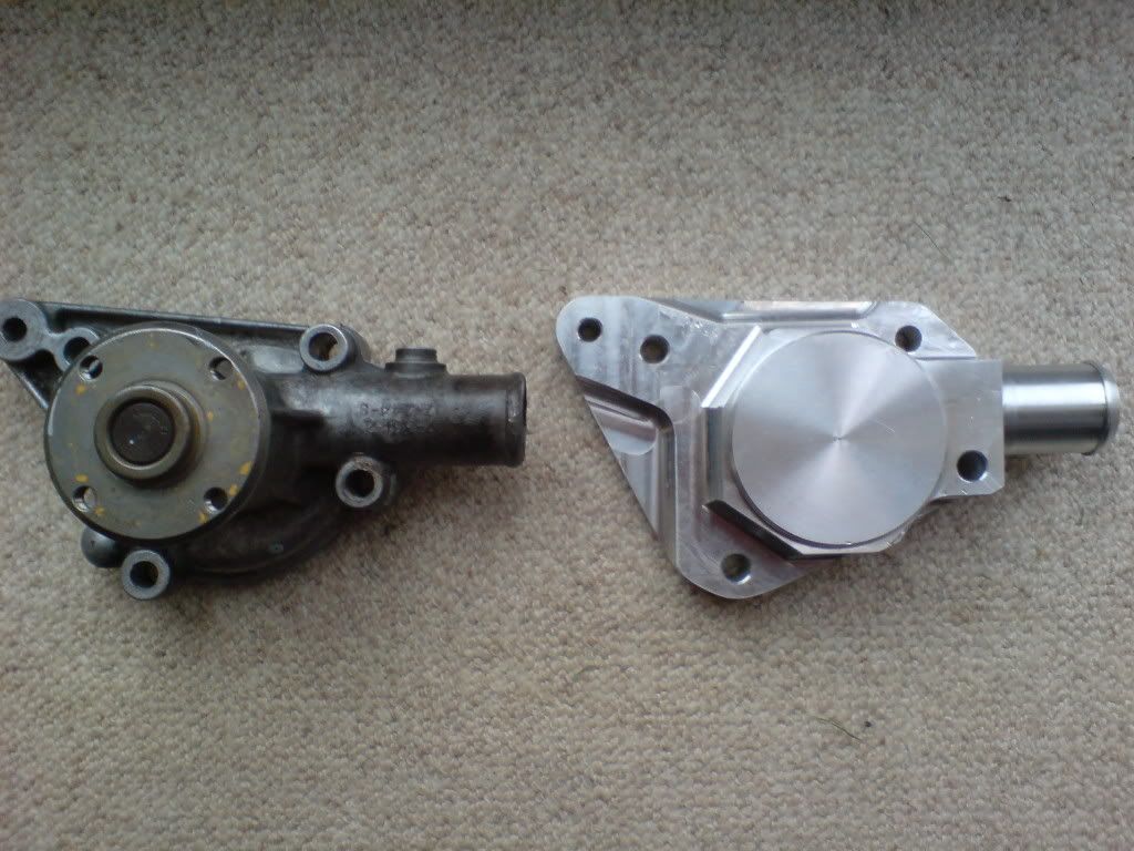

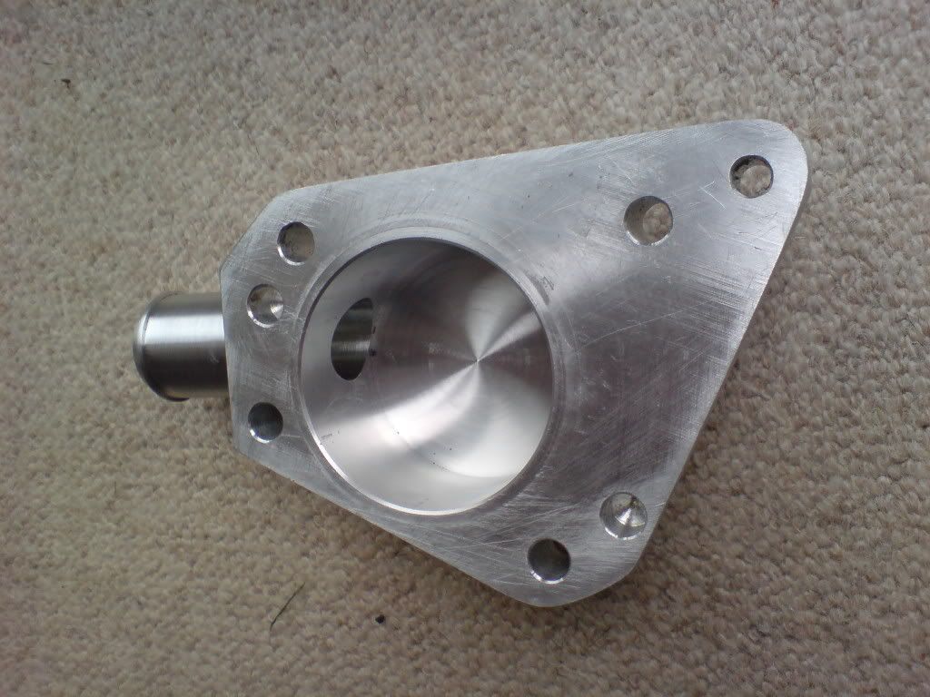

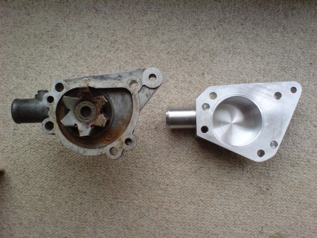

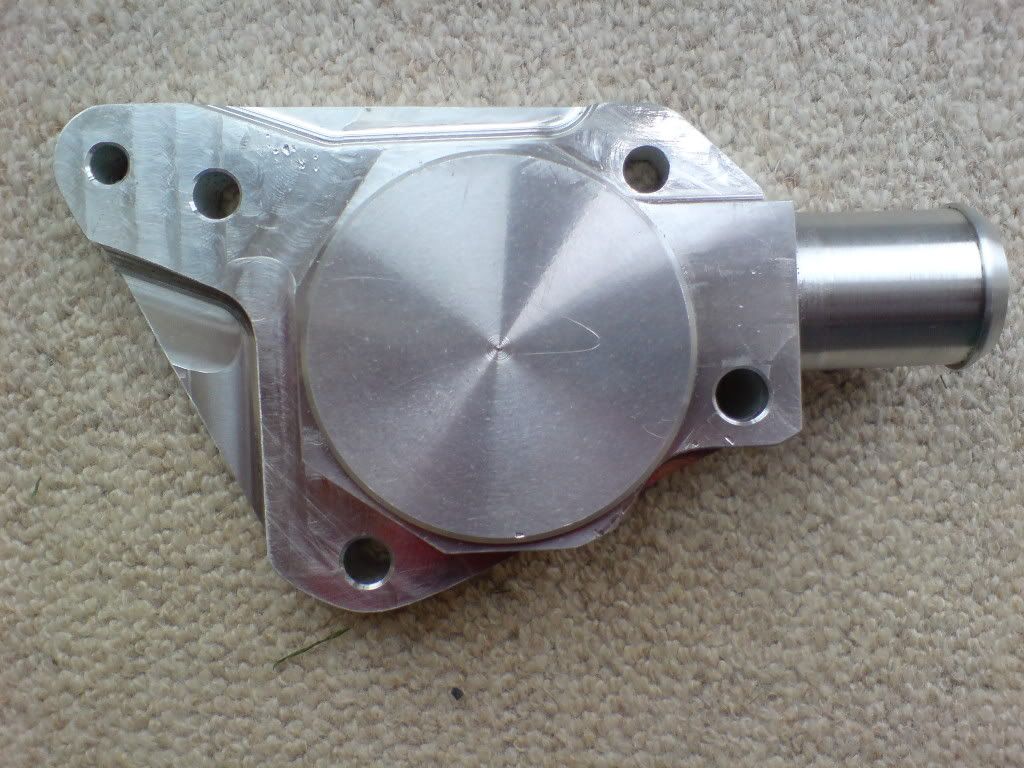

Just had this made to replace my water pump.
I just asked my local engineer guy if he could knock something up to replace the existing water pump assembly and he said "leave it with me."
Expecting a plate with a tiged on outlet. I was well chuffed when he presented me with this.
It retains all the original fittings no need for new bolts and pipe outlet remains the same dia to. So its a straight swop.
Happy as...!

its looking potentially awesome!!
that pump plate looks the danglies too

That pump replacement looks awesome! I take it you are going to use an electric one to replace it.

How much did that water pump replacement cost? Don't spose you could get another one made?

Also having made up a billet heater take off to replace those crapy heater valves to. Then next job is to get the pump replacement and the heater take anodised.
theoneeyedlizard :- Yep, electric pump just working out the best way to control it.
mikemph :- It was a one off mate sorry. The guy who made does not have the machinery to bang loads out. Must have taken quite a bit of time to turn it out of a billet mind.
Only other way is to take machine shop who could CNC it. But they would probably want a large order to make it viable.
Si

Oslo, Norway
check out slapheads homepage, he sells something similar.

loving the water pump replacment!
SH Stuff is top notch
6966 Posts
and at £28.00 is a fooking steel,unless of course it costs £40 to have it posted out lol, which i somehow doubt.

only problem with that one from SH is that it has larger water inlet than the original hose. I seem to remember its 1.5". He could make smaller ones at order for a little more money.
