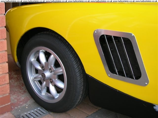

The cooling seems OK,with a combination of big cooling vents,a big fan,and a timer to run the fan 15 minutes after shutdown.

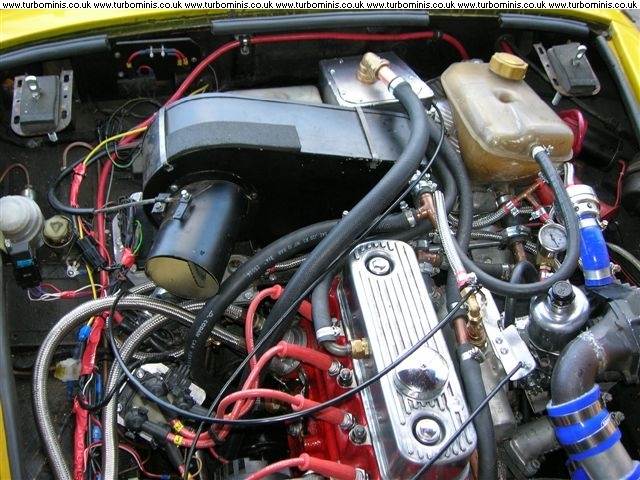

Two problems-a huge oil leak from the crank rear oil seal-I now have a HUGE breather system but no solution.Second problem is that the turbo does not spool upuntil 4000rpm,and then it's instantly on full boost.Tried fueling,timing and dashpot spring changes,maybe it's cam timing?(a Winter job).

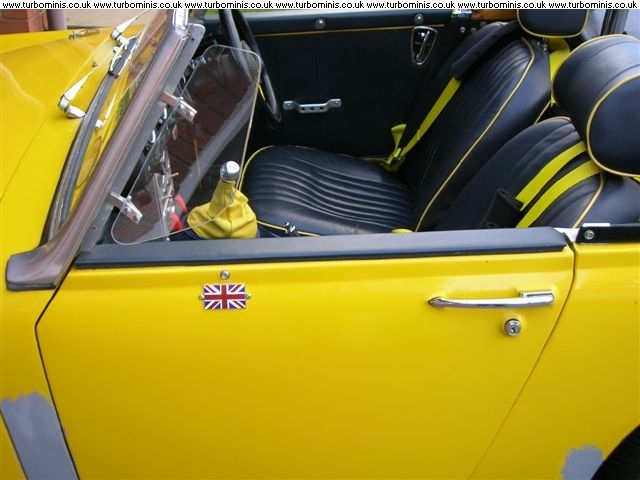

Final Question-I've shaved the back of the car,remote boot lock etc.(sorry Vegard,no bumpers),now I'm wondering whether to shave the door handles/locks.No weather gear,so the inside handle is accessible.Any thoughts?

Here you go.
Nice, looks a neat install.

Yup, rear main a real problem on my Midget too, removed the engine three times to try and resolve it. Ended up removing the dizzy and mounting plate and inserting a massing breather hose into the gapping hole, which did help! Peter May has a rear main conversion - http://www.petermayengineering.co.uk/specialistProducts.htm - but with this conversion you may need the rear main machined.
Also might be worth looking at oil grades (viscosity)? something I haven’t done yet, as thicker oil may help to prevent leaks, but there’s allot more knowledge peeps on this site that can answer that question for you!

I already have the Peter May seal on-it doesn't need machining.Frontline also do one,which is adjustable to centre it properly.As you can see I also put a big breather on the dizzy hole-but I wonder about oil viscosity,using Duckhams 20/50 now.

I also fitted the Peter May rear main kit, but ended up removing it, as with the kit fitted it leaked even more oil!
I did notice your dizzy breather, but I also removed the clamp and sleeve, (which I think you still have in place?), this allowed me to use a even larger bore hose. Is your breath tank well ventilated?

Sorry to disappoint you Carl,but thats the breather tank!I used 22mm tube sleeved and an o ring in the dizzy hole and 3/4 inch ID heater hose to the tank and to atmosphere.
