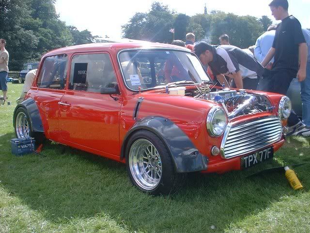

big?
6297 Posts
Hah, Hello MiniSpares, I would like some BIG arches.
kthxbye.
The rears look like migs to me, ive seen the front arches on a light blue clubman with gold alloys and vauxhall engine?
Not migs. Migs don't have visible fixing holes.
They look like an extraordinarily wide group 5.
My guess is that the guy moulded them himself.

Nah ive seen another set like i said above on a different car, look at where the arch goes inwards near the indicator.
They're quite large aren't they.
Just a tad, im looking to do something very similair once the tanjerine machine is finished. Maybe with a Vauxhall engine in! Ill also be doing the same bonnet but ill be making the bulge a tad larger.

They look similar to andy royal's minus that was in mini world few years back ? crap pic tho

andy royals look a bit like 2 sets of miglia front arches?
there is a whole craze in japan for these arches they fit them to everything out there!

Andy royals minus.
http://www.miniminus.co.uk/pictures/02%20-...yR%20-%2001.jpg
http://www.miniminus.co.uk/pictures/02%20-...yR%20-%2002.jpg

You cant beat a HUGE set of arches.
It jus getting the offset right that looks the problem.
There similair. Wonder where he got them from. Anyone know Andy Royal?

With wheels that wide it's going to be a handful even on a smooth circuit.
Is he running wider track (metro suspension maybe????)

What size wheels are they? Anyone know the make?
Roger explain?? Why would wider wheels make it a handful?
Andy Royals are Image Splits.

once upon a time i moved the wheels out about an inch or so each side so i could fit 10" wheels and 8.4" discs. the handling was scary. had no self centreing and needed 2 lanes of a motorway to slow down above 70mph
the car pictured is much wider than mine was. they must have changed the suspension to suite?
well in the pic of andy royals im pretty sure i can the hub nut, so i doubt hes spaced them, i imagine theyre just really wide.
Im sure they are special Narita Garage arches.
Where did you get the picture from?
It's all to do with the position the the imaginary line running through pivot points on the hub (swivels in a Mini's case) meets the road relative to the centre of the contact patch.
Most modern cars have this point significantly outboard of the centre of contact patch so if you have a tire deflate it produces a force balance that helps keep the car straight and stable so you can stop at a place of your choice rather than a hedge of the cars choice!
If you go too far the other way the car will dart about uncontrolably and follow the imperfections in the road to the point it tries to rip the wheel out of your hand.
To be perfectly honest anything more than a 6" wide rim (13" dia of course) on about an ET20 offset makes a Mini feel skitish and unpleasant to me, to the point I'd want to fit power steering to be happy I could hold on to it.

Yes even my reverse rims can get a little hairy when trucks have worn tracks in the road!
