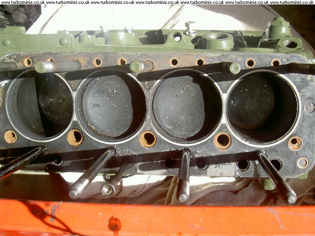

I took my head off to be sent to steve, as he's doing my cylinder Head.
And my pistons are abit black after 7000miles.
http://www.turbominis.co.uk/_photos/random...os/683/4081.jpg
What's the best stuff to clean them with ?
Cheers..

Are you removing them? If not leave them. You'll just push grit down the bores above the rings.
Im not removing them no....
Hmm so guess thats not a good idea then

what do you gain by cleaning them?
apart from getting grit down the bores?
Coz there black. thats y it smoke at the start for a while... so thought i could get all the crap offf ?

i agree mate leave alone or try the water as water realy cleans them up in a controled way.
They'll get black within three miles when you get it running again. Also, it makes a great thermal barrier. Cover it all up, leave it.
Funny how you get so many different answers... *tongue*
But you learn who's the pro's are who's the amateurs *wink* lol
Ill leave it if it's not problem.. just looked abit scary in there *surprised*
And being brought up to be a clean boy and all that lol
Cheers...

Well, it seems as you've already managed to get som crap down there. Use pressurized air and try to get most of the loose stuff up. Be careful not to blow it down the ring land.
No, got no crap down there. not got near it since the head was off.
Anyway, ill do as u say and leave it alone *wink*
Cheers ppl..

No I see grummley bits down there.

That was already like that when i took the head off ????
Ive blown it the best i can.. but still dont look that great
