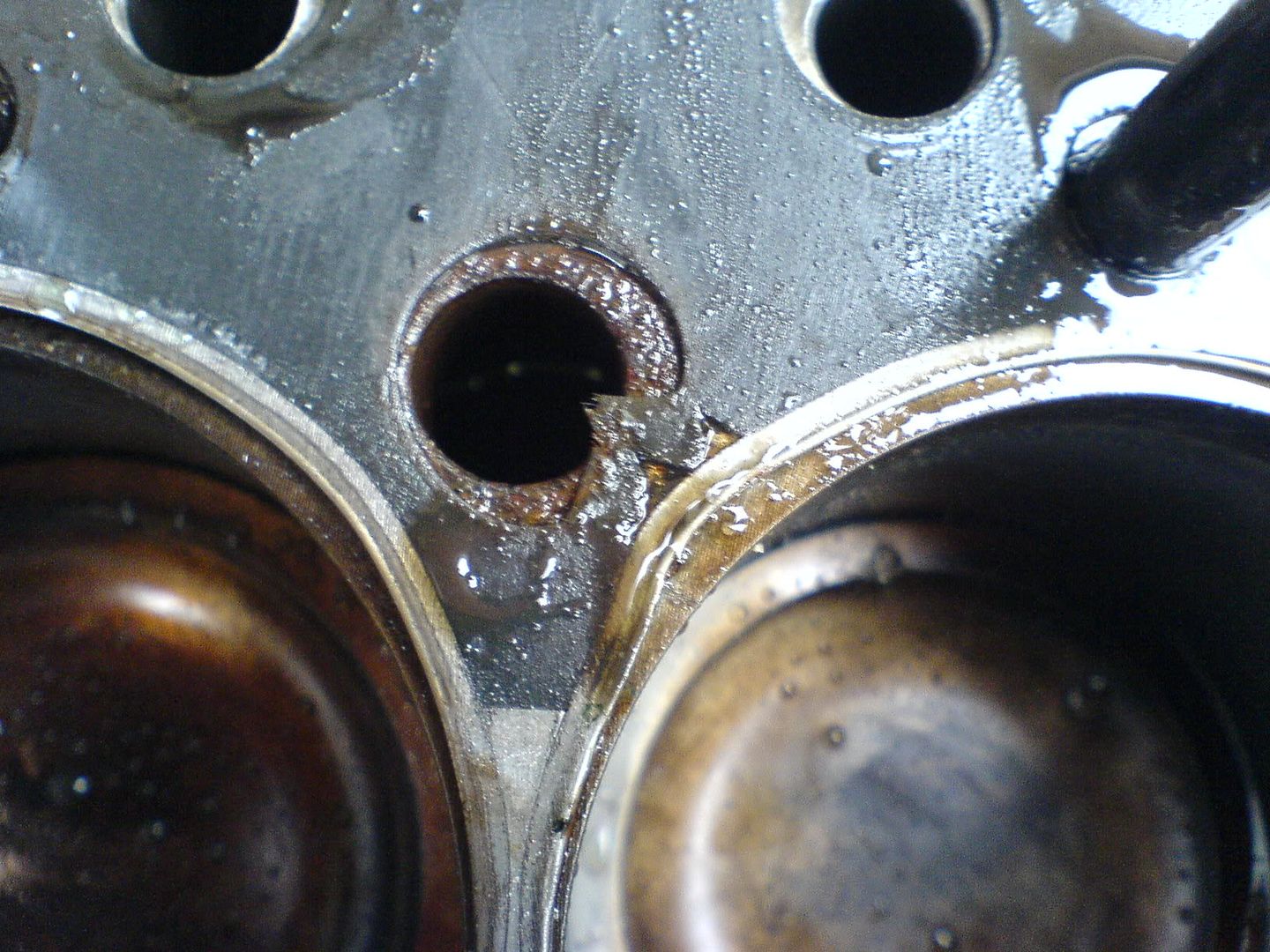

Got me head off today
and here are the results:
Cylinder 2 that the water was coming out of appeared fine, though there was a bit of damage around the coolant hole towards no 1:
The coolant bit of the gasket and ring around 3 was knashered:
Fortunately theres no serious damage and everything looks fine down the bores
Whats causing this then? it was getting a bit hot recently (105deg max), and the gasket was about 1.5 years old but none of that is excessive
Did i manage to detonate it or something on that ring? There was a bit of it hanging off when i pulled the head
Im seriously thinking about dry decking just to improve on reliability
Now to find some money from somewhere....

No wonder it conked out on ya.
You running pure coolant?
Am i right in saying miglias use dry decking? Might be worth looking into.
mmmm,
interesting, One thing I don't like with the BK450 is the size of those holes, also I'd line to see a copper support like in to outside 2 of that row.
could that be an option? drop in a copper washer? although getting the thickness right could be an issue.
I wouldn't bother going to the troubel of dry decking, not on an engien tat is alteady proven unless it was being rebuilt.
Maybe try a comtec (or similar) solid gasket on it?
I guess it could have been a bit of det that caused it, but i wouldnt have expected 1 and 3 to go together, as 1 should be cooler than 2&3?.
also whats this on no 3...
a red circle???
hahaha ill take a closer look
The same place that the gasket failed on The DON, from the waterways in the centre of the gasket.

Dry decking won't stop your gasket doing that...
but it will stop it finding its way to the coolant...
I'd investigate why thats happened... what do the piston look like?
AlexF
6753 Posts
looking at the piston colour nic , id say thats got a bit hot and detonation has occured ,but something else that i thought of was could the head have lifted a bit ,when was it last torqued down ?
the whole heat saturation of the block could well be a lot more if you drove it there and could take it over the det threshold ,compared with trailoring it and having it a bit less toasty ?
on the other hand it was a cooler day by far than the shootout ,but then ,,, it was trailored hmm .
any chance of iffy fuel ?
it was last torqued when i replaced the gasket, fri before avon 06..
The only other time i blew a head gasket is when i drove to avon too....
The psiton looks fine, there is a bit of damage you can see, but that happened ages ago when the end fell of a spark plug, grrrreat! The gasket has been changed since then
Actually robert you could be onto something there...the car was set up on optimax-98 octane, but this time i was on 97 texaco stuff, hmmmmm i couldnt say i heard any pinking or detonation but its not very quiet in there
That thing in the red dot is a spot of carbon, it doesnt look like it in the pics but it is
Im liking the idea of dry decking just to improve cooling circulation, and when the head gasket does inevitably go it wont mix the oil and water together, and looking at these pics the water seems to be effecting the gasket
Looks like the gung ho hi boost final run claimed the gasket then eh Nic??
yep, curses

dry decking will not give you any improvement , it's a must when using alloy heads , but with both irons (head/block) you'll better keep it like this ,
this coolant passage doesn't seem to have affetcted the HG , what I see is a bog good det that have blowed your fire ring, then it did find his way to the water one,
what caused this is certainly mentioned earlier, a hot running, 105° is really to hot to contain det,or a bad tank of fuell
I would certainly investigate the ring land to see if it didn't been shot too. (I did find some pistons with a nice crown that have a ring land exploded in two)
A last thing that could have improved the scene ( :) Robert):
when it's get hot , the expantion pull your studs ( elongate them), when it does cooling it doesn't retract then, as a result, the clamping force have been lessened,a µthu each time.
the only way to recover it his to retorque your head after some numbers of heating/ cooling cycles cqsd

i had prety much the same problem as you nic, mine blew into number 4 cylinder ,was running 10psi boost and was just after it was dyno Dunno why it happened either but i just guessed that maybe it happened when we were dialing in the timing. Replaced it and hasnt happened since so i dunno.
oh and i use bp ultimate
1152cc turboed mini clubman, most powerful 1.1L a-series?
http://boostmini.justboard.net/
oh well, live and learn
Though i wasnt running 105
deg up the strip, but my car had seen it earlier in the week when the earth for my fan vibrated loose and slowed it down
And for next year i think i may start retorqing the head every once in a while too then

Doesn't hurt to re-torque regualrly.
I've always checked the torque on my engines every time I have the rocker cover off to do the tappet clearences (which I tend to check quite often after having an adjusting screw come loose a few years back).
Also some people swear by re-torquing after a certain number of heat cycles on competition engines.
Are you going to drop the pistons out to check them?
Prob not, but ill see how carried away i get
