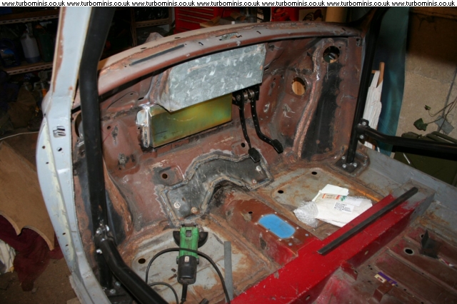

2. The inside with the pedal box in to get the seat position right.

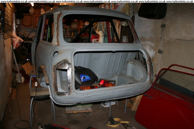

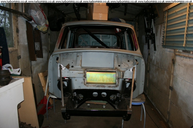

3. The rear end. When I got the shell it had some awful round lights welded in so I have had to cut them out and rebuild the panel.

Interesting choice of shell-stands! I'd be careful building too much weight into the shell in case some of those legs start to buckle!
is that some double skining between the subframe mounts in the second pic?

Tom, You are not the only one to say that about the stands. It wobbles a bit, but they will be fine for this part of the build.
Mini13, On the original TT we cracked the floor there so now we just put a strengthening plate in to help.

Alex, Exactly my thought. I have been abuaing them for years no problem. Each one will take 100kg easy. It will be back on the pallet trolly before anything heave goes on.

Up on its side to cut out the boot floor, weld in the seatbelt mounts and generally tidy up the floor.
Ex-don subframe cleaned, fixed and painted.

Getting started on the bodywork, filling the rear lights where plates had to be added and starting to finish the de-seaming.

oooooohhh another :) is that a plate around the steering rack a bit of a stiffening exercise? may steel that ideawhile i have the welder out *tongue* looks cracking!
Yes. That part of the floor is piss weak, and with solid mounts it helps a lot. Done it on all our shells.
