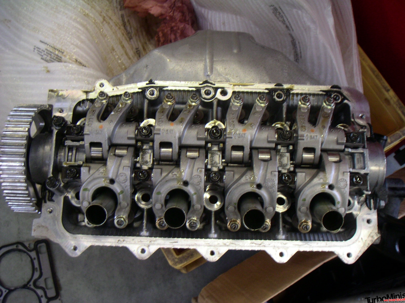

16 tiny valves :
http://www.turbominis.co.uk/photo/518/
One happy OHC :
http://www.turbominis.co.uk/photo/519/

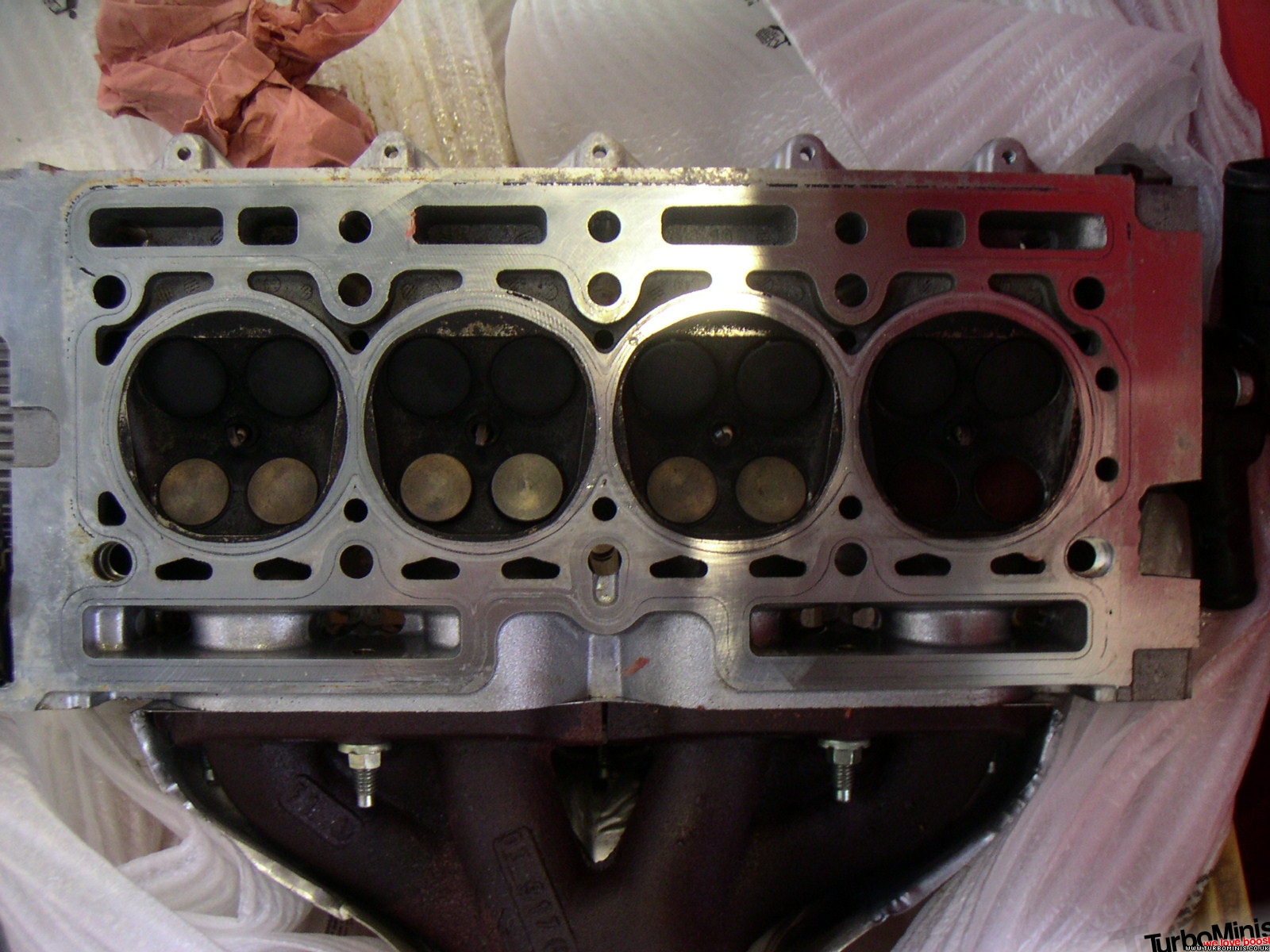

Willingfull bore spacing :
http://www.turbominis.co.uk/photo/520/
Cool oil but not so happy water routing layout :
http://www.turbominis.co.uk/photo/521/

I feel I can have trouble with a 1275 as bore is only 70mm and there is not much to remove before the silicon lines
What do you think ?
Small valver, ain't it ?
Rusty by nature
Can you take a pic of how it looks on the block and from the undeside of block to see how bores line up?
