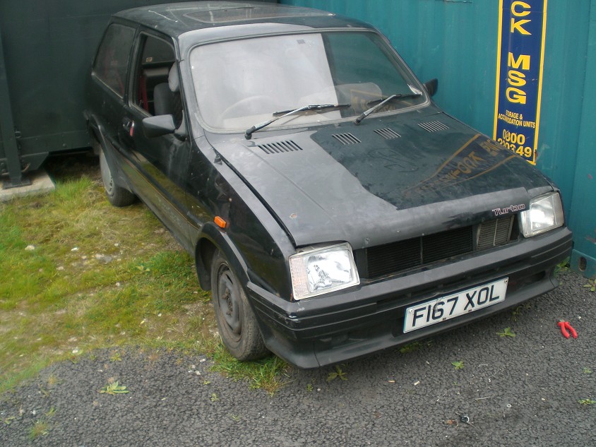

any pics of the metro turbo?

PS have attached a pic of the metro for the person who asked.
