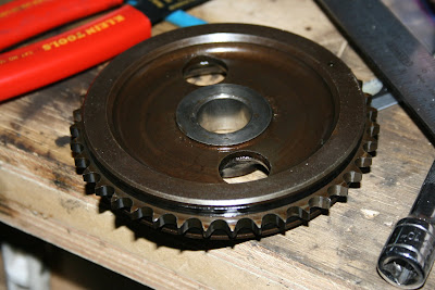

FYI, here is a picture of an old a$$ timing chain gear...
which I replaced with a normal gear (without the rubber rings, which I assume is from an A+ with a tensioner) because someone machined the back of this one (which Rod helped out on also). My assumption is that the rubber rings were not doing much of anything before...the engine would never notice that they were missing.
Ahhh, I see your dilema, your new sprocket doesn't have the grooves so you cant fit the rubber rings anyway...
Although Tadge thinks otherwise, I can't see how you could fit the tensioner to an older backplate and get the cover on.
To maintain backwards compatability with the blocks, they used two holes that would have held the old style cover on, to hold the tensioner in place and the extra (11th) hole (on the larger cover/backplate joint) doesn't go into the block, it just uses a nut and bolt.
EDIT - I just realised what Tadge said - you CAN use the same plate (just drill the extra holes) but what I meant was you CAN'T use the same cover..... I was wrong earlier when I said the shape of the plate is different, I should have looked properly first *frown* It's an optical illusion because of the gasket outline...
