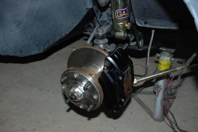

he you go mate
S disks and mini spares 4 pots, i had to convert from drums but was surprisingly easy lol.

thanks :) how do you find them?
what bolts will i need for the flanges? will they come with the flanges or the brake kit?
cant beat a good blowout.
So long as the fitting kit has the bolts/plates/pins listed by dan-up, sounds OK.
The only "suggestion" I would add is to put new conical washers in when you fit the new flanges (the tapered one with the split under the big nut) - these are often an issue with preventing the wheel bearings being preloaded correctly, especially if they have even been let come loose and hence got worn.
