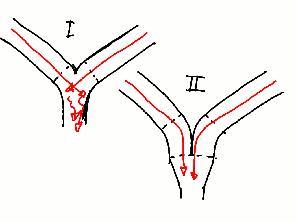

Hi Paul,
You may want to reconsider the design of the Y-piece. The problem, as I understand it and why I decided to re-do my own manifold, is that the exhaust gases will lose a lot of momentum through a collision in the Y-piece. See my, terrible but hopefully clear, drawing.
Sketch 1 is the situation with the collision. The gases want to go in a straight line as there really is not that much of a bend to follow and bump onto the wall, loose speed while trying to find the right way to go.
Sketch 2 is the situation where there is a proper bend before the collector. Gases will follow the bend on the outside curve and will be properly aligned to go into the collector and not lose as much momentum.
What do you think?

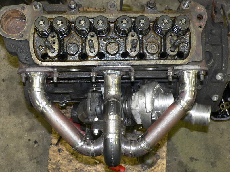

thimo
22 Posts
Member #: 710
Amsterdam, The Netherlands
This is a photo from my manifold. The flow in the center pipe will be okay, but the outside ones will lose pulse/momentum.
Edit: Link to more manifold photo's, remarks in Dutch:
Edited by thimo on 3rd May, 2009.
http://projects.ferrenzo.nl/
Thimo, you may well have a very valid point and a collector style joint would be better.
However, packaging it all together and leaving space for a 50mm downpipe leaves little space. A collector would push the bend much further down and I'm already battling with the webs on the block as it is. Moving the pipes away from the block intruduces some odd angles and takes up the space for the downpipe.
I think I'll spend some time over next winter working on a better design, but I'm going to finish this one as it is to get the car working.
Did you ever try your manifold? Or are you working on a theory?
