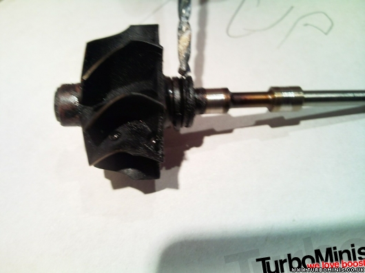

Right i have just stripped down my 1752 to inspect the damage and its very clear that the seals on the hot side were completed shafted. The disk/oil thrower thing was saturated in oil. This explained why oil was in the manifold too but not in my head ports. I am guessing that the oil was being thrown up the inlet and wetting the manifold.
Could you chaps just confirm my suspicions, upon removal of the main shaft i noticed a small groove on which an oil seal should go?"see first pic"
Also there are some major grooved in the shaft its self, im guessing this if fucked too.

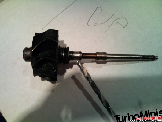

"see second pic"
Anyone got a spare shaft i can pinch?

Yes. That is bin fodder.

its just the ring that does the sealing mike ..its important that its a nice tight but free sliding fit in the groove .. if the groove is worn wider than the ring by much then it wont seal .

I found the groove in the shaft had a step worn into mine which made finding a seal the right size hard to find. *oh well*
Chaps i have aquired a newe shaft which isnt baldy damage like the other, however when trying to fit the oil seal spring it appears the slot has something in it.
Heres a pic
and the second pic is my original
Original Shaft
Thats looks like a step has been worn into the shaft...same happend to mine.
What is the fit like? I should imagine quite sloppy! Lol
No very tight, as if the collar thing has metled and merged with the shaft?
If that makes any sense.
Right mine looks fook all like this one of roberts
Looks like on the hunt for a shaft again.

stuffed if i can make it all out from the pics mike ,...can you get it any clearer ?
Giz a sec and ill upload some decent pics.
Right some better slightly blurred pics but it s the best i can do
Click the pic and youll get a huge one.
That's fucked that is :/
mike ,whats happened is the ring has spun ,worn the sides of the slot ,and caried on doing this ,until its made a wide flared groove ,and the deformed metal has blended the bottom of the slot so it looks really thin .ulp !

the GT15's at my old work were same construction, i used to re-man then and ALOT had wear like yours, exhaust housing full of oil too.
piston clips worn down the groove
bearing surfact doesnt look particualy healthy either
