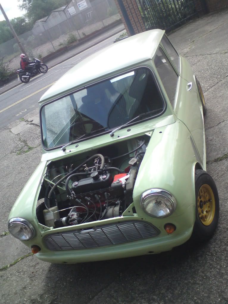

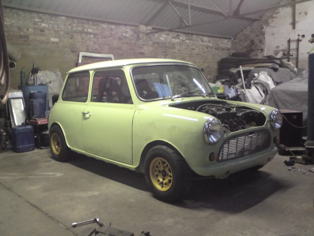

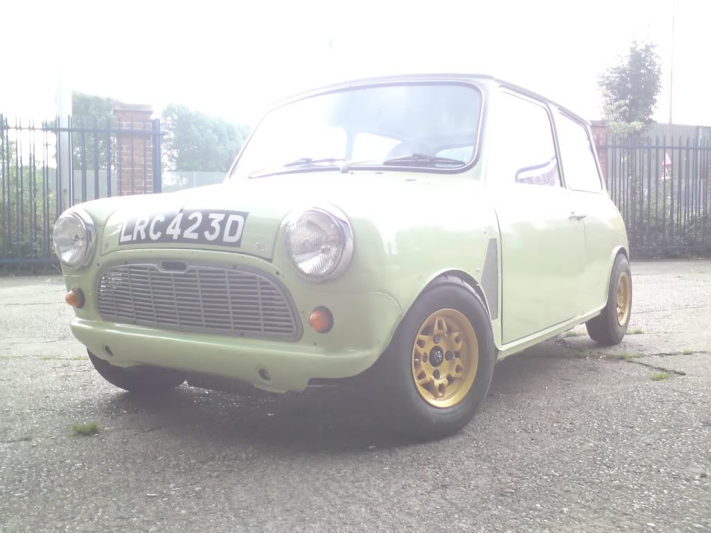

Heres some pics of the car, hope to hear your (truefull)
thoughts......

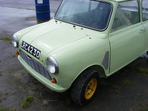

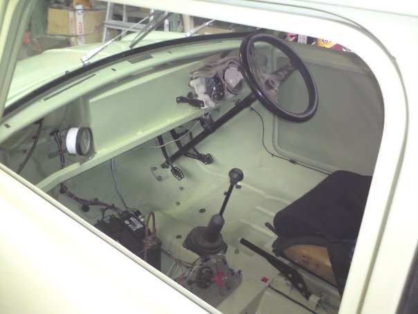

Your floor looks lovely. I don't think I could get my arse in your seat though....

Looks good, can you reach the wheel when strapped in?
So what engine is going in it?

only just! i need to sort a drop bracket or even ad another uj to brin the wheel at a more manageable angle.
the engines a the MED short engine, balanced crank, race head, dellorto dhla carb.

looks nice and clutter free

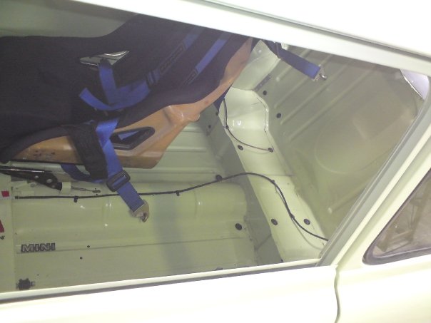

i presume you reinforced your harness anchor points? the rear seat back is obviously no way strong enough by itself
I love this car
This is the yellow one from Pod, isnt it?

Looks good. Is the plan to sprint it? Dials look a bit plonked in, what's the plan?

sprint1380
67 Posts
Member #: 6876
Burton-on-Trent
yea i remember. its fiesta yellow (apparently). i do intend to sprint it, my local track is curbrough. The dials have changed, the standard ones are gone and a new panel is fitted.
i need disk brakes for the front, then the coil overs will mount correctly and at the correct angle. its gonna take a while to get it ready but thats the plan.
got my eyes on a custom cages historic cage, and a minispares cross pin diff. carnt afford an lsd yet.

Nice. What's hiding behind the vent in your passenger side A Panel??
Somebody is selling 2 sets of cooper s breaks on TMF for £200....

the mounting point is welded to a bar which is then mounted to the boot floor. that will change, as i dont like the way its mounted, i could also do with the space for a bigger fuel tank. the cage has harness bars so il use those.

nothing, its a vent for the rad. il check them out. cheers.

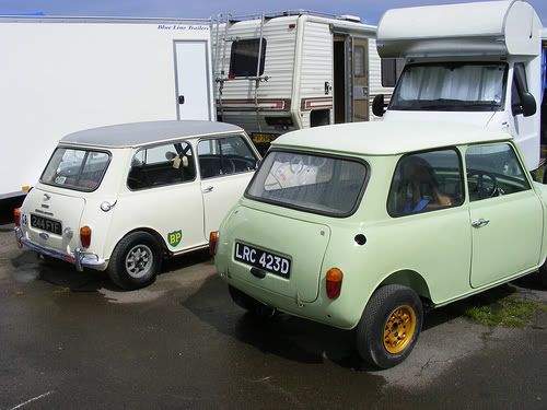

Si P
784 Posts
Member #: 912
North Yorkshire

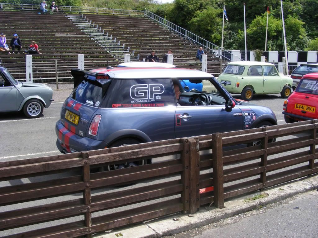

Your car caught my eye on the way down to MITP. Saw it on the trailer on the motorway.
Thought it was a great looking car.Also nice to see it run to.
What was your best time of the day..?
SI

best time was 14.36sec

Whilst drunk at avon me and jim picked this thing up
Its got to be in the really low 500's
