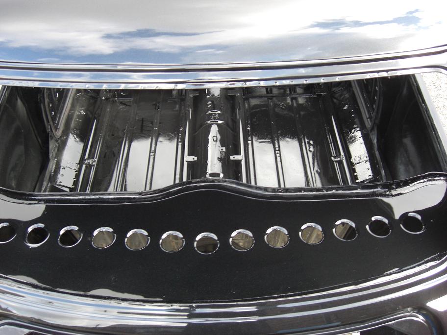

I've seen lots of people who have 'swaged' holes in their car.

Much easier when you know what to search for - hole flare tool

I brought a 20mm hole flaring tool off ebay. Cost £18. The bloke who sold it did a load of different sized ones. I've so far used it on the turbo bonnet and the vauxhall minis A panels. Looks sweet. |

I've got one off ebay, it's ok but I've ended up replacing the bolt with a 12.9 cap head as I stripped the threads off the bolt that came with it, I also use an inch long nut to try and stop me stripping the threads and also allows me to clamp it in the vice, also as it's ally it's starting to wear. Isambard Kingdom Brunel said:

a bearing under the nut goes a long way to making the treads last on bunches and swages On 28th Aug, 2011 Kean said:

dam, im glad i made one of these up when i had the chance. mine does 35-40mm , twas easy to make from steel bar stock, but geting the profile right on the radius took a bit of trial n error.

Seeing as theres a big pic of my car at the top.
19th Apr, 2010 at 07:20:24pm
Finally got round to buying a set of these from the ebay chap. All look really good quality and they came in a nice box.
