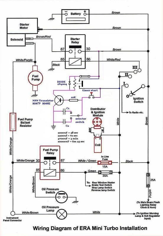

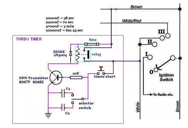

This is the setup i was going to use in my car
The idea is, you can have two time settings by choosing the capacitors, C1 & C2 to build it with and selecting either with a switch.
Then when you park up, you hold the start button for say 2 or 3 secs, then switch off the ignition, and it keeps the engine running for the set time
Not quite the finesse of a proper one, but should do the job
Home built for a bout £4
This shows how it would be wired in
Think it should work although haven't got round to trying it yet
Dave.
