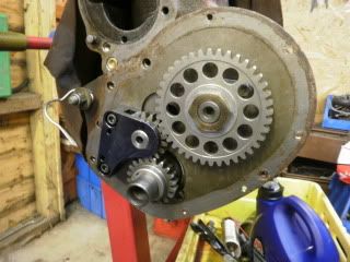

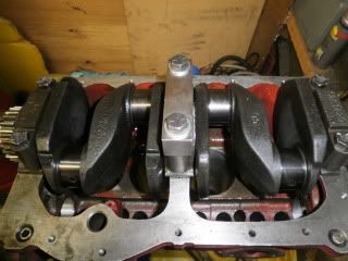

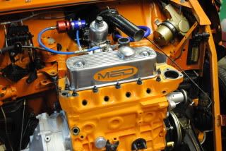

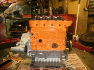

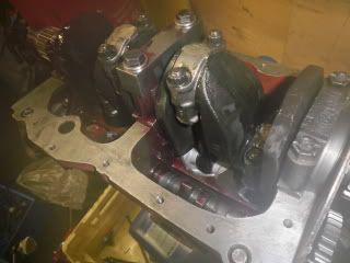

hi all just a few pic of my new 1293 engine build8-)
im getting there slowly:)
this is my mini it going in

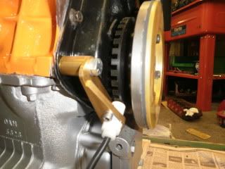

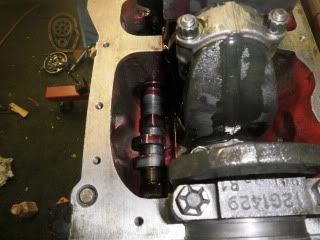

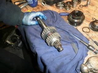

like that timing gear!
My exact thoughts rubi.
Ben H
3329 Posts
Member #: 184
Melton Mowbray, Pie Country
I like the timing gear too, but it is adjustable? If not it would be a shame.
http://www.twin-turbo.co.uk
nibble36
116 Posts
Member #: 4273
stoke on trent
yes it is adjustable on the cam gear behind the nut 9 holes and each hole give you 1 degree advance or retard + eash tooth on the gear give you 7 degrees , im useing a med t3 cam it got be timed @ 110 degrees, its a shame you have to cover all the good looking bits up lol

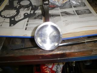

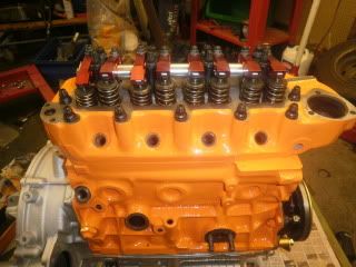

Looking good. Supprised no ones mentioned the centre mains bolts, might be worth checking them, they like like 3 dash.
Snap look like 3 dash to me too.
Im liking the timing gear too, never seen that setup before. Looks like a great way of accurately setting up the cam timing.
Bet they are noisey though. I believe someone Andy from ML Motorsport used them on his minus once and removed them because of the noise.
I stopped worrying about noise years ago...nothing a set of ear plugs won't sort out! *hehe!*
nibble36
116 Posts
Member #: 4273
stoke on trent
its having straight cut drop and gear box so it will be noisey any way lol......
the centre main strap was from MED and the bolts will have a look at em
thanks for the advice guy

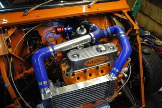

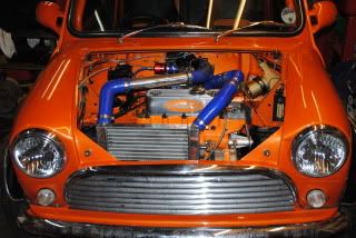

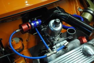

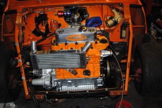

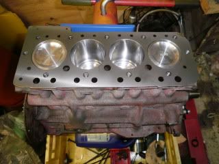

hi all been betting stuck in tp the turbo build here a few more pics not far off fitting it now :)
bigdog
3 Posts
Member #: 8288
lookin good
Nice.
What did you do about the 3 stripes in the end?
nibble36
116 Posts
Member #: 4273
stoke on trent
i spoke to the guy at med (as that were i got em from) and he said they be fine they use them in all the engine build
pulse
112 Posts
Member #: 2011
Ashington, West sussex

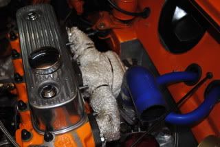

I like that allot! Same as the others about the timing gear but also the crank sensor!

I had a set of those timing gears on my 1330 N/A and they where mint!!!! Had them from Slark. Didn't produce anymore noise than a standard setup.
Do you have a close-up photo of the actual bolt head ???
nibble36
116 Posts
Member #: 4273
stoke on trent
no its all together now

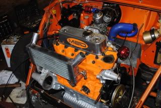

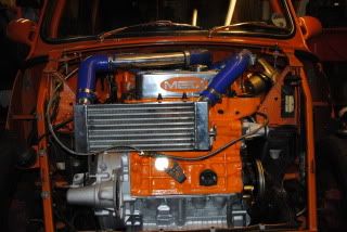

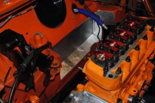

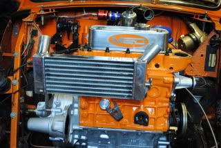

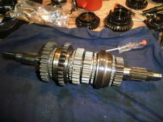

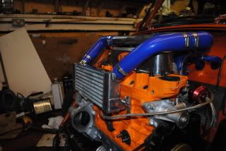

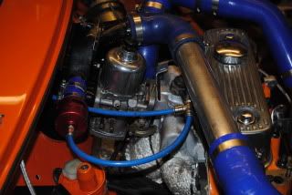

few more pics it all coming on ace got take me intercooler in have some brackets welded on but going well
Prawn
667 Posts
Member #: 5232
basingstoke
Nice looking car, SO clean everywhere!!!!
EssexSteve
556 Posts
Member #: 7029
Wickford Essex
like it too!

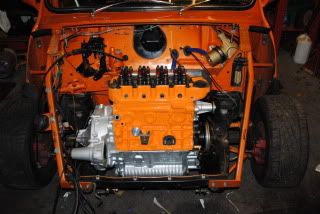

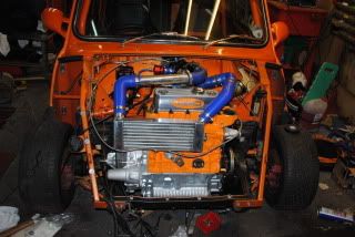

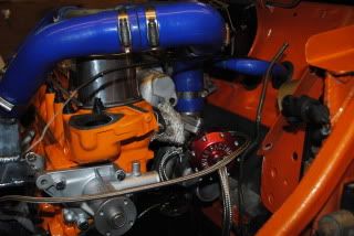

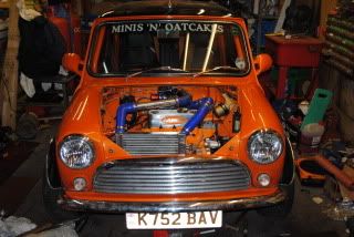

ok been working in the shed all day and got abit done to day it coming togerther now few more pics:)
