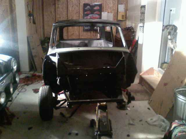

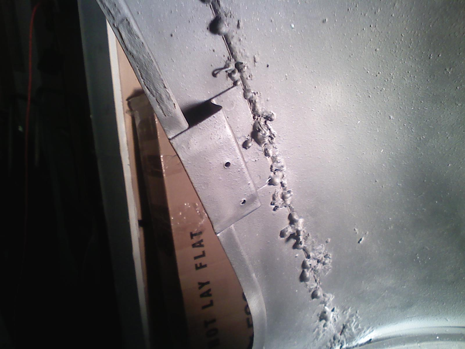

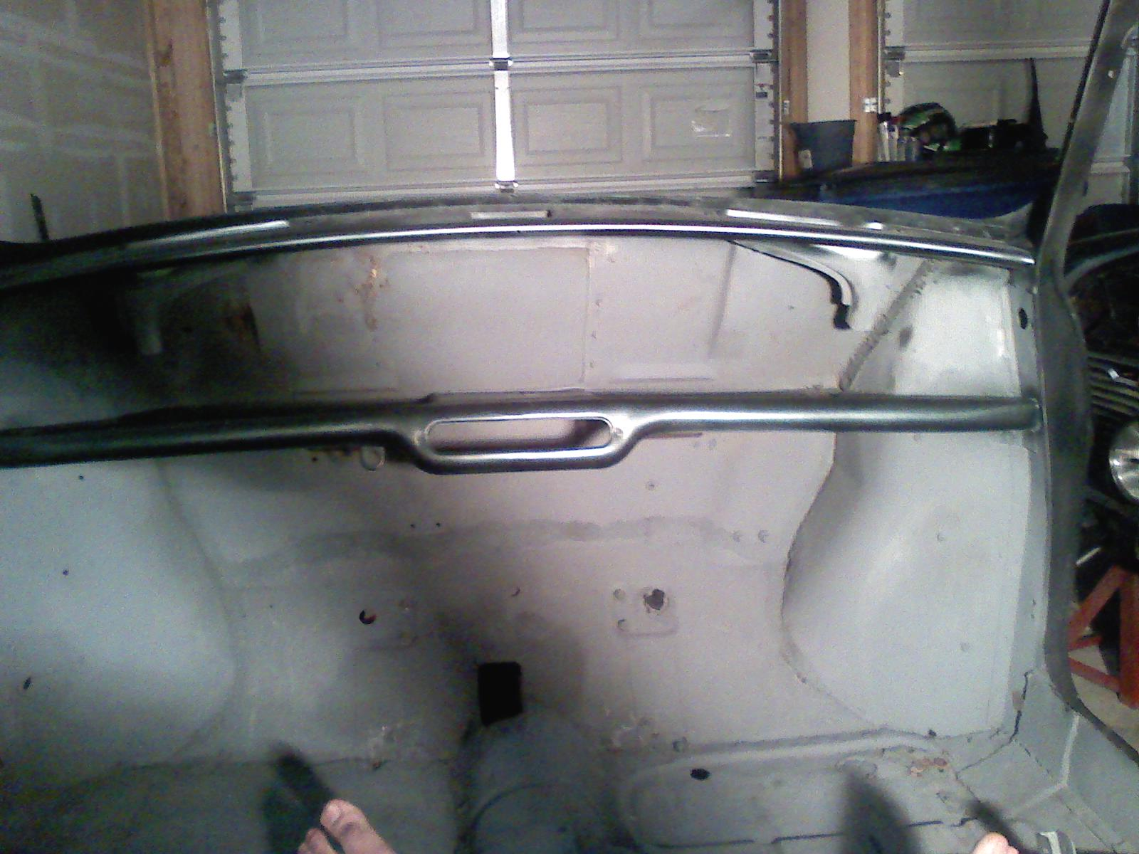

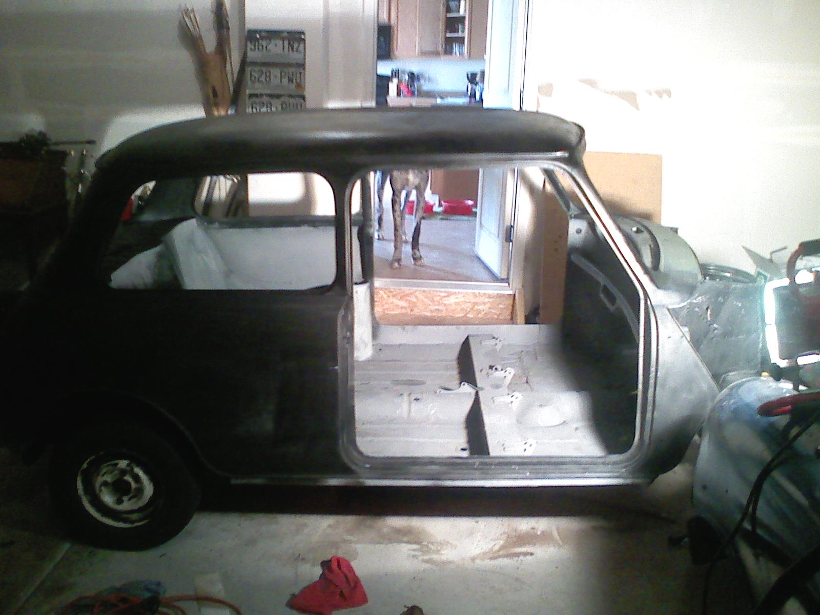

Here's some promised pics. Ignore the toes please, lol. And I have a pic in there on the rear window, meaning the 1/4 glass with a bracket. I've not seen this before, is this for the 1/4 opening glass? And the mini that seems complete-ish, that's the donor.

That link should take you to my album, and I have it set to open, so you shouldn't have to log in to see it. I have Carbon weezel doing me up all the stuff I need, it'll take about 8 weeks to get, and then off to my painter, and then I can start in earnest on everything else. Figured it's about time I pull the finger out.
