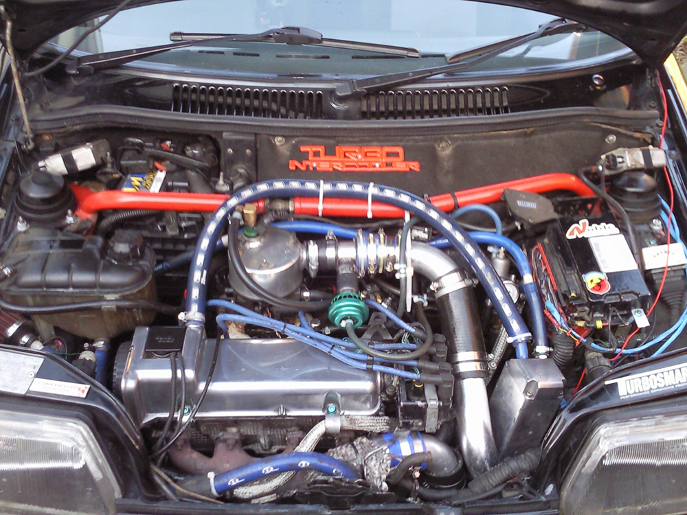

28th Feb, 2010 at 12:37:02pm
yes i have some photos of my my set up and turbo ill pop some up below.
28th Feb, 2010 at 12:43:12pm
That looks like a GT1544. There are two different versions of the GT1544. You will need the larger one.

I would say that you would be better off with a full GT1752, not just the compressor. The GT15 turbine housing will be restrictive.
28th Feb, 2010 at 01:16:20pm
Yes it does look like you are going to be falling off the map of the smaller unit,
