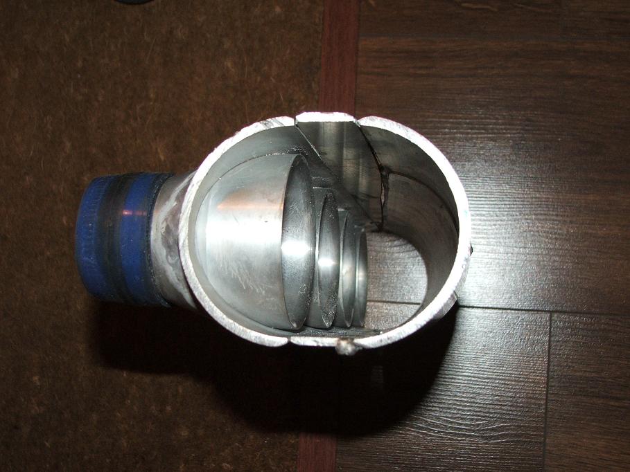

Well, this is the current state of the Miglia Turbo inlet:
29th May, 2010 at 01:31:19pm
What volume are you using inside there Paul ???
Schrödinger's cat - so which one am I ??? |

29th May, 2010 at 02:09:20pm
On 29th May, 2010 Rod S said:
What volume are you using inside there Paul ??? I've worked on 1.3 - 1.6 times the engine capacity which I've read on here and other sites is the optimum for forced induction but it is giving me lots of problems fitting it all physically in. Yours looks smaller overall (although obviously a photo can be very deceptive). It's around 1850cc for the cylinder (10cm dia by 23.5cm long), so it should be around the correct volume. By the time I add the taper it will be near the 1.6 times engine capacity. The 998T is running something similar, but a bit shorter, so it is also running at around the 1.6. Although that has much longer runners, overall it gives a very torquey feel and revs well. Saul Bellow - "A great deal of intelligence can be invested in ignorance when the need for illusion is deep."

29th May, 2010 at 02:22:09pm
On 29th May, 2010 Paul S said:
It's around 1850cc for the cylinder (10cm dia by 23.5cm long), so it should be around the correct volume. By the time I add the taper it will be near the 1.6 times engine capacity. That's good, it looks less in the photo. Mine is virtually 1.6 (on a 1360) but a struggle to fit despite my using a rectangular section which should be more space effecient. Well, actually it won't be 1.6 anymore as I've just hacked a bit out of the bottom to try and run the compressor outlet pipe "through" it...... Next one will be a lot higher up and further back but shortened to clear the clutch master cylinder. Schrödinger's cat - so which one am I ??? |

I guess that it is a constant flow simulation in CFD.
