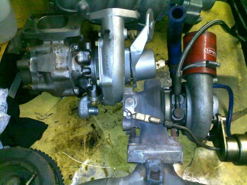

Isn't the TD04 a bit on the large side?
They are readily available (compared with the gt17) so i had considered one for mine, but I was put off after a few discussions with other members.
To clarify, I'm talking about the TD04 as fitted to the Saab Aero's.
someone on here has/did/does run A td04 with good results

Sean the GT1549 like Im using is a good choice and available brand spanking new Japan Auto trading in SA, the only problem is that the exhaust flange is triangular and not square.
The TD04 is also a good choice but I do remember that the Saab guys use it as an upgrade to the GT17.

Here is a pic showing the diff between the bigger T3 and the TD04H as fitted to my 1600 16V GM motor.
