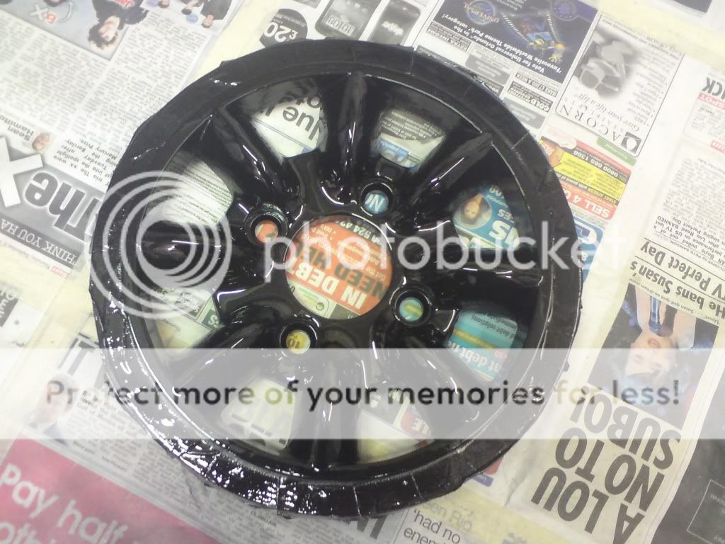

12th Sep, 2010 at 06:31:18pm

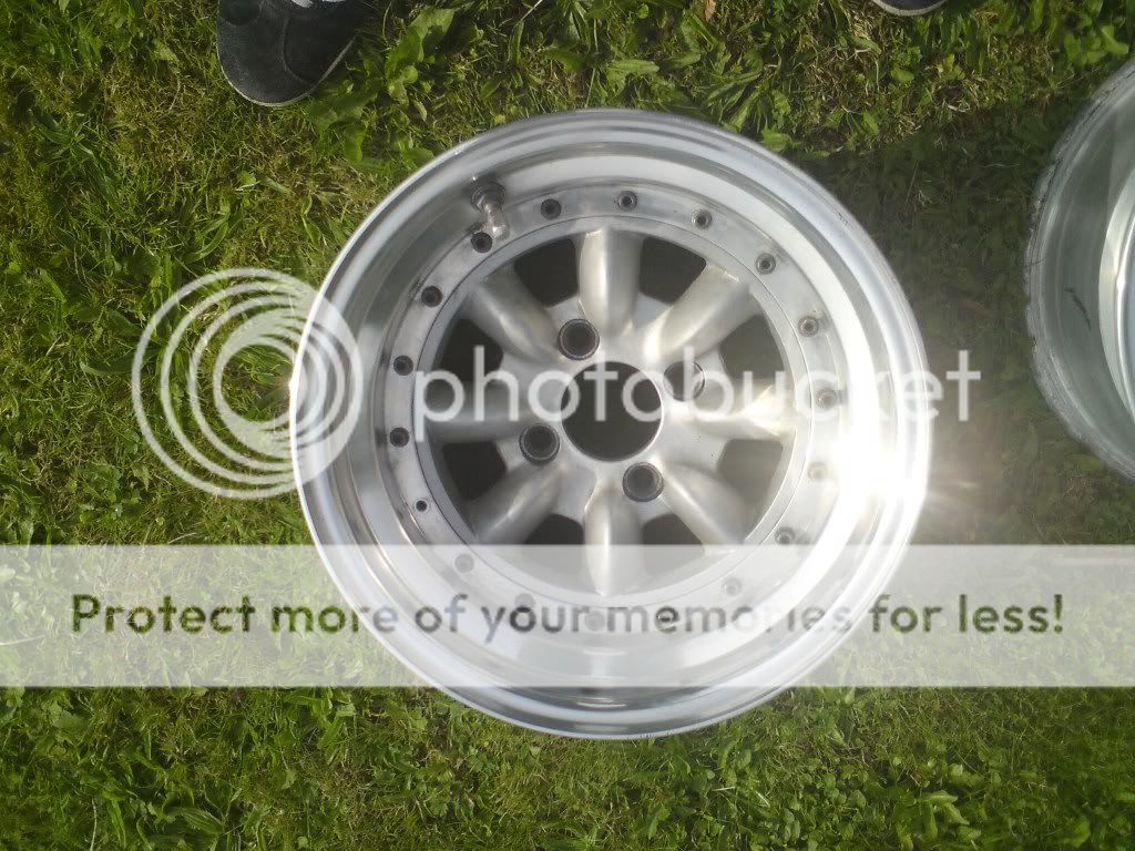

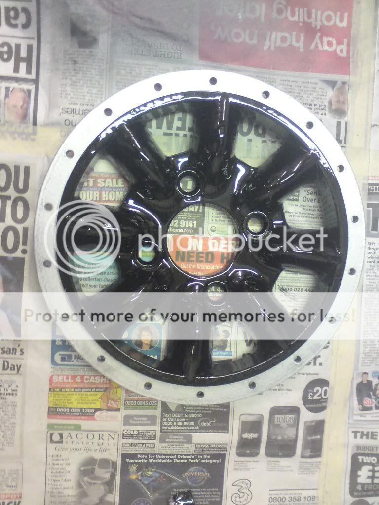

hi, i picked up a set of superlight splitrim alloys some time ago for my car as featured in my build thread.
Edited by welshdan on 12th Sep, 2010. |

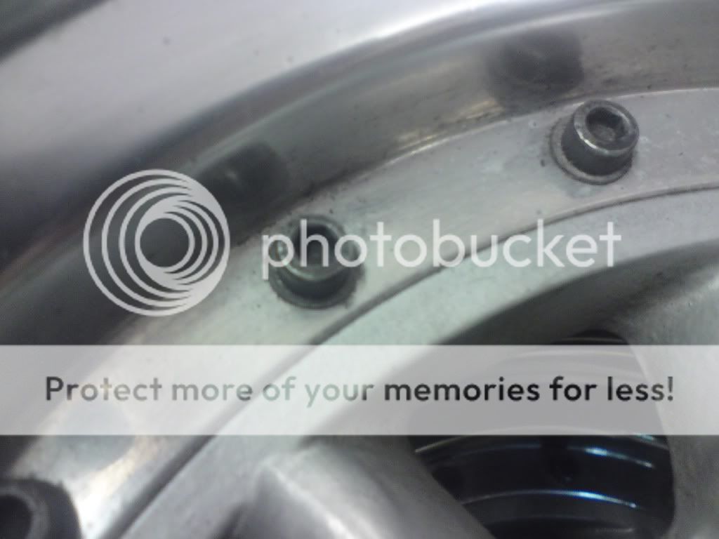

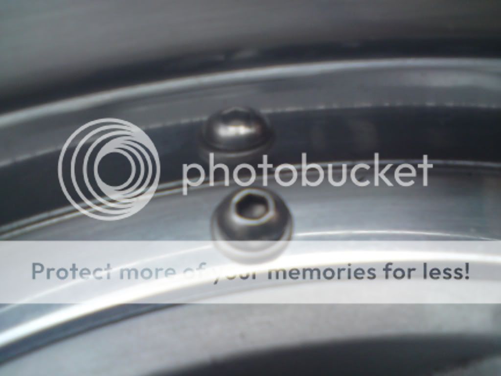

12th Sep, 2010 at 06:35:18pm

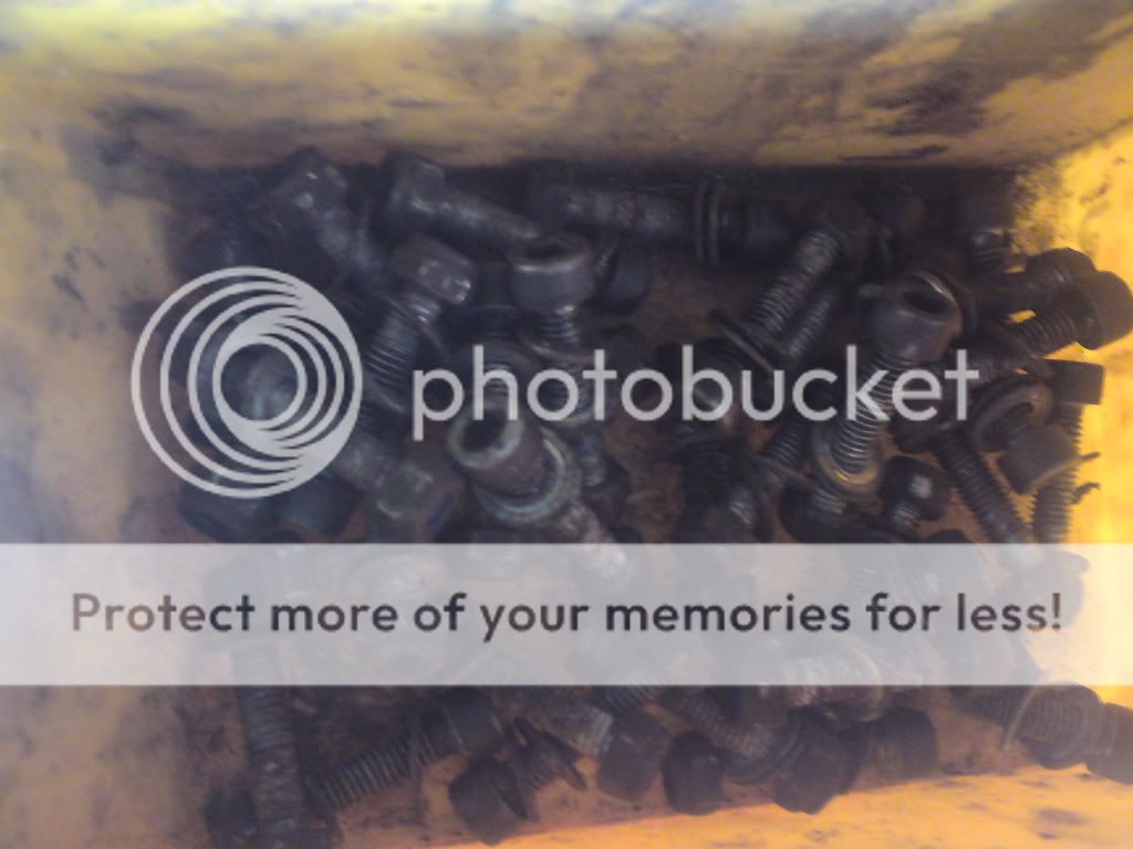

What rating are those bolts? |
2096 Posts Member #: 1111 Post Whore s wales |
12th Sep, 2010 at 06:40:32pm
not sure, but they are quality rs items. with 18 of them per rim, it will be ok. |

i know when we did keans on his nissan we used normal silicon, i'm sure they were M6 bolts though, M4 seem a bit small to me? On 20th Oct, 2015 Tom Fenton said:

i think its m4 off the top of my head. - ordered the bolts a long time ago. though they fit perfectly where the originals were fitted. following searches, quality silicone seems to be the best thing to seal the rims.

i didnt think stainless even had a high tensile rating

my brother has a set of revo splitrims. they were fitted with stainless bolts from new. |

Stainless bolts are not up to the job. What you want are plated cap screws grade 10.9 minimum.
12th Sep, 2010 at 10:10:34pm
An A2 or A4 class 80 stainless screw is equivelent 8.8 carbon steel. There are A2 or A4 class 100 whih are equivelent 10.9 carbon steel. I would give RS a call and see if they can find out what strength class their screws are.

12th Sep, 2010 at 10:23:33pm
On 12th Sep, 2010 Tom Fenton said:
Stainless bolts are not up to the job. What you want are plated cap screws grade 10.9 minimum. Tom. I'm intrigued. Purely for debate, surely if you're gonna exceed the UTS of stainless on 18 bolts put together then the ali wheel must be fubar anyway well before the bolts can exceed their loading. Or am I missing something here ? Is there a shock loading to consider ? I've used A2 stainless M6 socket allen caps previously on a set of MB 13x7 alloys before. This was on a road car, not a racer. Certainly more aesthetically pleasing and easier to keep corrosion at bay than plated HTS bolts. Richard. Minivanless, but reluctantly happy living with the decision. There'll be another one day.
Site Admin ![]() 15302 Posts Member #: 337 Fearless Tom Fenton, Avon Park 2007 & 2008 class D winner & TM legend. |
12th Sep, 2010 at 10:27:28pm
It is more work hardening in stainless that then causes it to go brittle and fail well below its rated tensile strength.

12th Sep, 2010 at 10:32:03pm
It is more work hardening in stainless that then causes it to go brittle and fail well below its rated tensile strength. That is my understanding of it in any case. So, if A2 st st does get used, would it be worth undertaking a more frequent bolt torque check or even a complete bolt replacement at say, a yearly interval ? Minivanless, but reluctantly happy living with the decision. There'll be another one day.
12th Sep, 2010 at 10:33:59pm
silicon works fine however iirc stainless bolts dont have the shear strength Crystal Sound Audio said:

A common misconception, even amongst some of the engineers I have worked with, is that stainless bolting is "stronger".

thanks for the input re the bolts. they will be bolted back together with what i have, but i will look to change them in the future.

not wanting to piss on your fire, but I'd change the bolts to a grade you know what is, I've seen a few nasty miglia crashes due to the bolts failing, instant tyre deflation, not like a normal puncture.

Its probably the last sort of debate you wanted to open on your wheels - look very nice by the way! but what Tom, Jim and others say is true - S/steel is not a good use for wheel bolting, the problem with "re-torquing" is you are yielding the bolt each time you do this - not a good idea on a brittle bolt or 12.9 grade, 10.9 can cope with a little re-torquing, 8.8 a little more - but you'll not find quality cap screws in 8.8 grade. Beware also zinc plated 12.9 cap screws as they will suffer "hydrogen embrittlment" and snap in a similar manner to s/steel - unless you have a conformance cert from the supplier to say they have been treated for embrittlment - read expensive.

The other thing to consider is that stainless and aluminium make quite a nice battery. Much better off with mild. http://www.twin-turbo.co.uk
