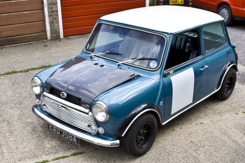

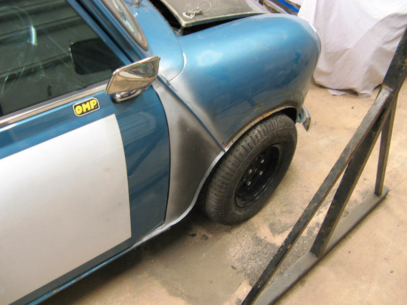

And here are some photos of where we are at.

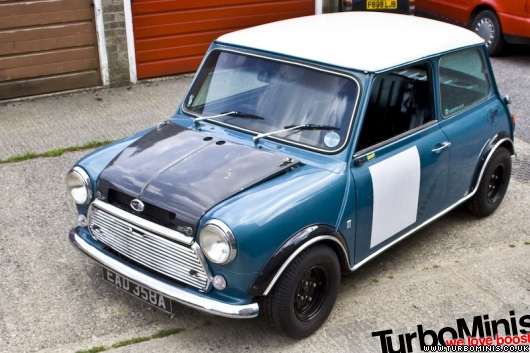

This is the car when I MOTed it:

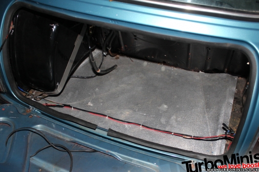

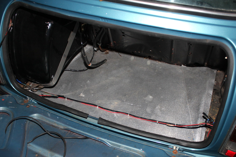

New boot floor (not having one caused an MOT fail)

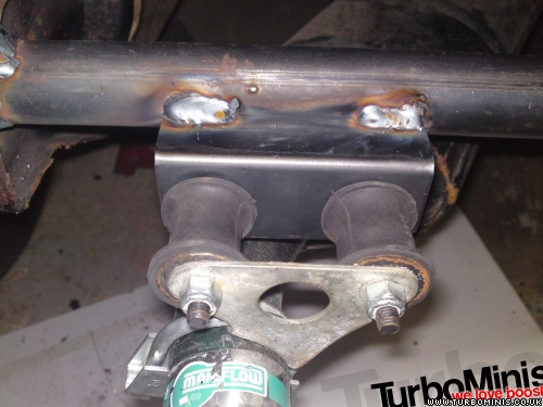

Exhaust mount & Subframe bar (again, this was an MOT fail)

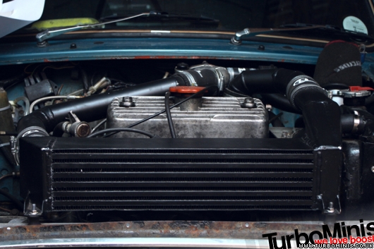

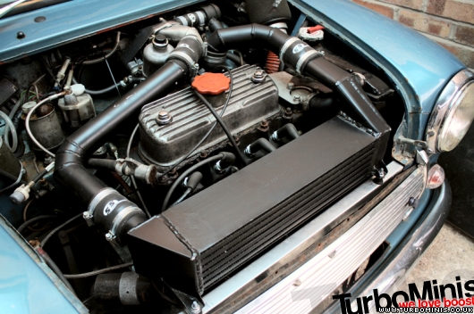

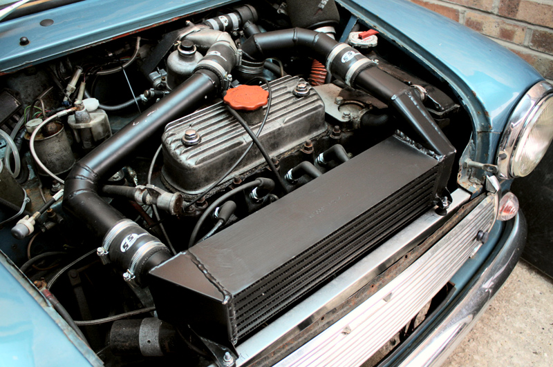

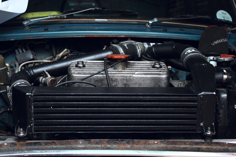

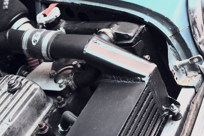

New intercooler pipework, mounts, and end cap

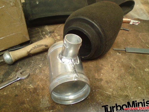

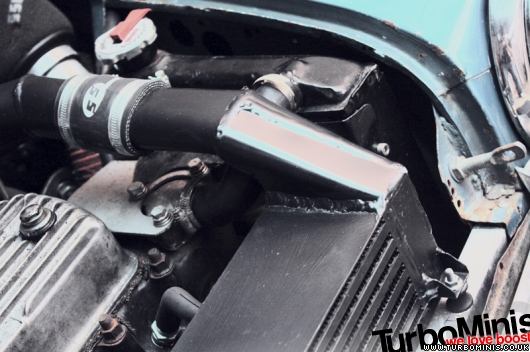

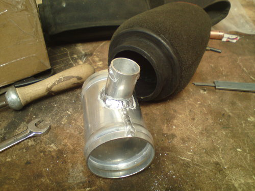

Dump-valve inlet
And the finished rusty area

YEAH!!
I like the new intercooler pipework, very neat
Very good. Will be good to see this at Avon/Pod next year.
I cant see the pics.
Good to see youre back on it though Al
Paul
Yes intercooler install is very neat.

I'll third that on the intercooler pipe work, very neat, nice looking car *smiley*

Intercooler looks excellent.
yep, excellent work there too *tongue*

Pipe work & intercooler look tidy in black,very smart!
Cheers Ross.

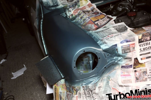

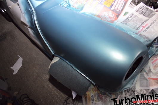

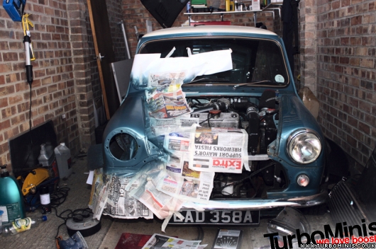

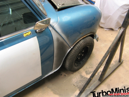

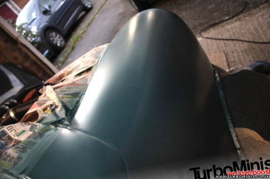

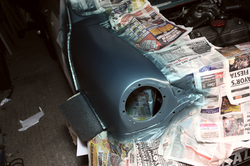

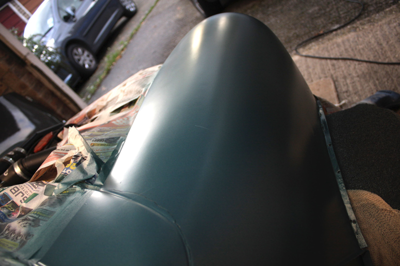

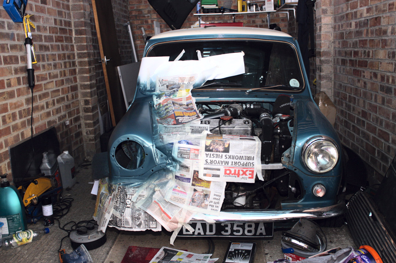

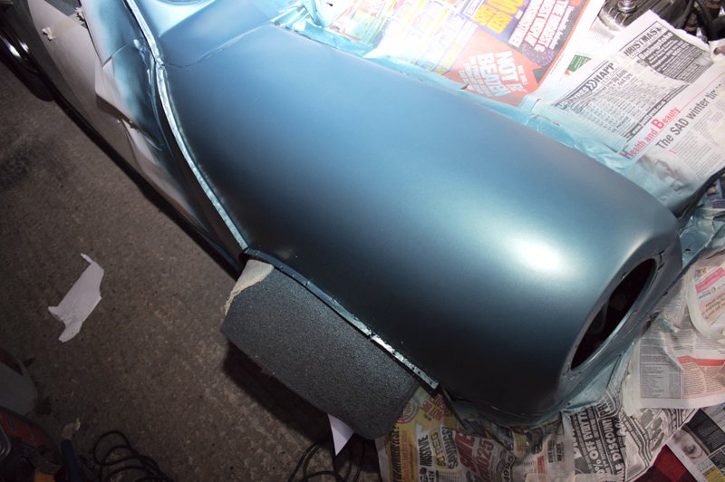

Just a quick update. I got some paint, and have started to paint the A-Panel and wing. I'm not so much doing it to fix any dents or rust, but to make the car 1 colour.
It's my first time of painting, so I wasn't expecting much, but I'm happy about how it's gone so far. I've done about 3 coats of paint so far, and have a few more to do then glossing. I think the colour match is OK, but not perfect, but it's going to look better than having a big black panel. Only downside so far was that I scraped a bit of the paint with the bottom of the can earlier - but that will sand out and hopefully wont be noticeable after I'm done.
I also decided to paint the whole wing so there isn't a hard line between old and new paint, and to remove a few obvious rusty bits.
Here's a few pics of the progress so far (oh, and ignore the mess / whatever as I don't care)
-a

Looking good. Can I just ask why your exhaust mount was an MOT failure?

The exhaust mount wasnt, but the bar part was - the subframe had the rear removed (i.e. it was a C shape, the sides and the front) - it failed on being unsafe, so I had the bar welded in to replace the missing part, and an exhaust mount welded onto that.
Al, a tip to help you blend the paint in.
Where you mask off, do a rollover with some 2" masking tape. This will give you a softer edge of paint which will be easier to blend into the surrounding with some cutting compound before you lacquer it.
I'll do you a paint drawing, 2 min.
6297 Posts
Thanks Tom - good advice, I'll try that tomorrow.
