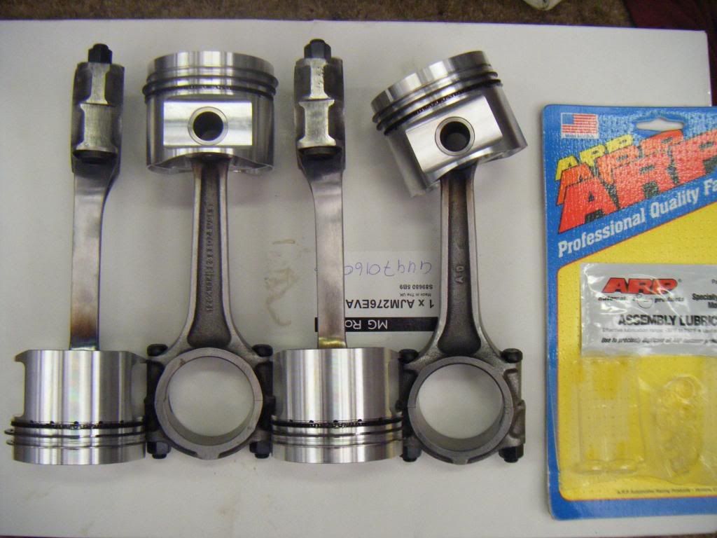

Here's my rods
Edited by madcatminis on 22nd Jan, 2011.
I'd peen them, just for good measure. I've used Rob Selby previously, very happy with the work.
However, those rods needs to be lightened first.
