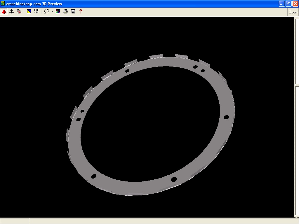

Create a dxf file using CAD...I'll knock one up in 1mm mildsteel for you.

Nice! Only issue is the size of teeth. Trying to bend them over on a curve will be abit of a mare. *oh well*
