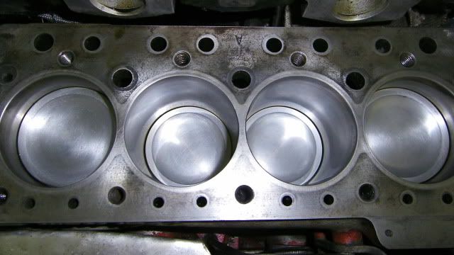

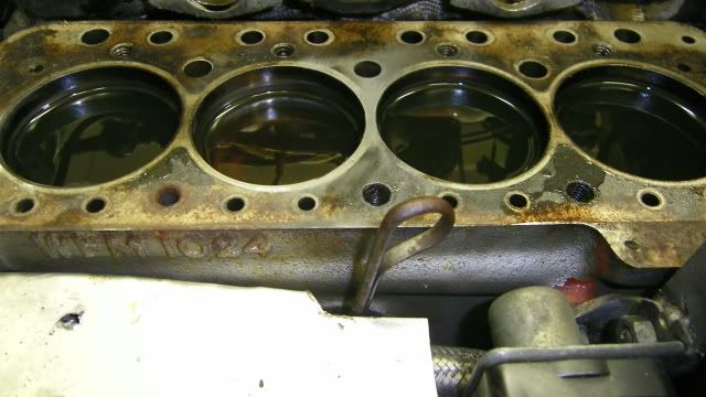

head gasket was eaten through for about an inch betwen 2 ,and 3,. pistons look perfect . filled bores with oil ,not moved ,but maybe just too thick to drain down .
now the q is , is there anything about a blownhead gasket in that position ,that would make smoke ?
oh ,no smoke on the way home .and after it went onto 2 it never smoked again .
im tending towards a total strip and no 3 piston is cracked ring lands . but i thought its worth putting a gasket in and seeing if it still smokes .
pistons are omega casts .
smoke was bluish grey
no rise in water temp on way home .

cracked ring lands? will smoke but wont drop oil in the bore?
Denis O'Brien.
only thing i can think apart from shagged lands is it was sucking oil from the push rod holes,
sorry denis ,was that a question ?lol
yes joe i wondered that , it was v oily on that half of the gasket , but the fire rings were shiny silver ...
along the same lines...maybe more likly is it pressureised the crankcase via the pushrod holes.
I guess all you can do is whack a gasket on and hope :/

hmmm ,well the oil waa bit further down in no3 .
but a leak down test gave 8%9.%8.%11% hmmmm
Give it a try for the sake of a gasket Roberto!
Robert when my ring lands packed up, i could just see some damage if i looked down the edge of the piston. Stick the gasket on and try a comp test.
Mike
Edited by MikeRace on 12th Jul, 2011.
Have you cleaned the block between 2 & 3?
errr , moight have done ..
