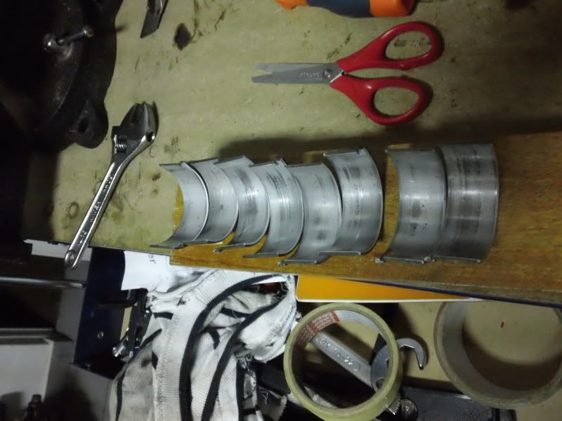

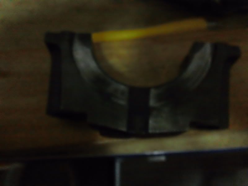

bearings are totally shoot, so will go in the trash.

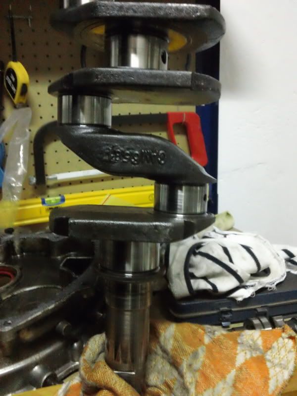

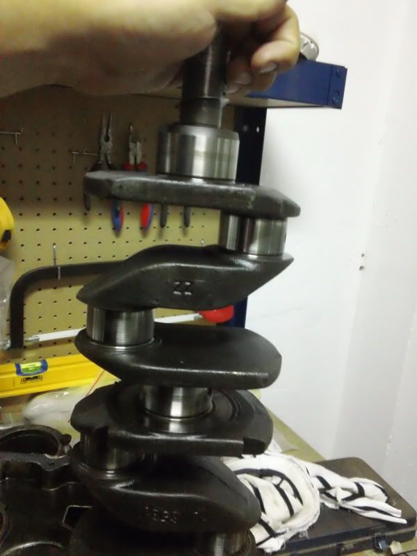

crank seems fine to me as is, but what do you guys think?

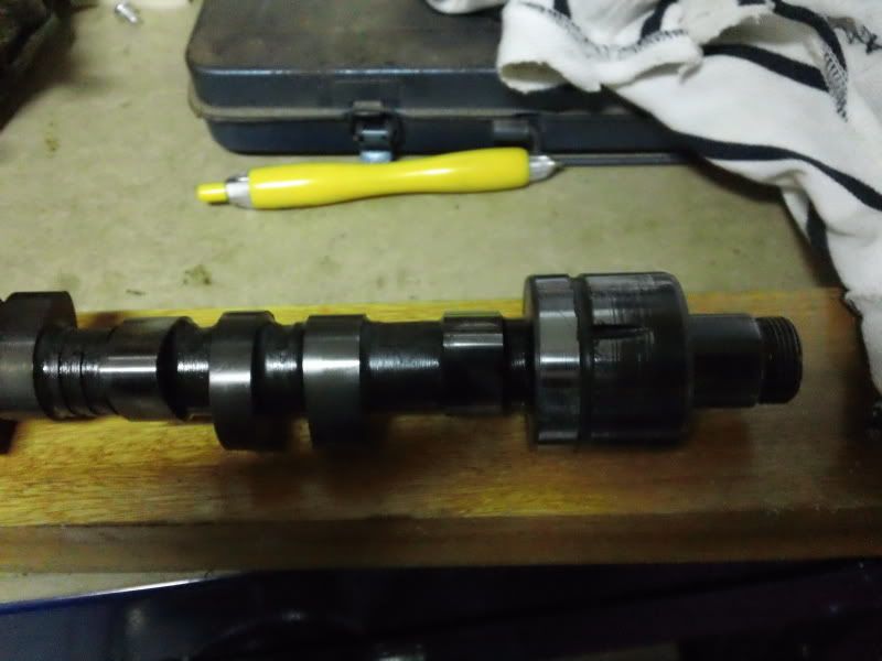

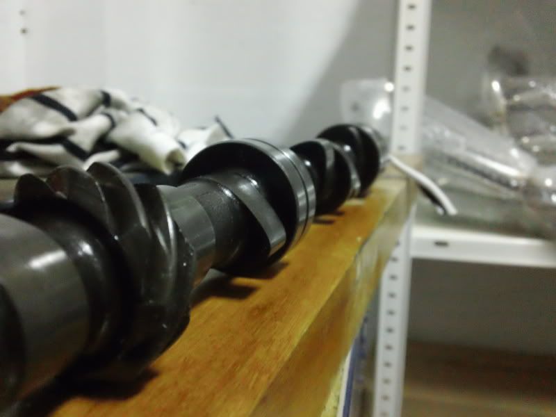

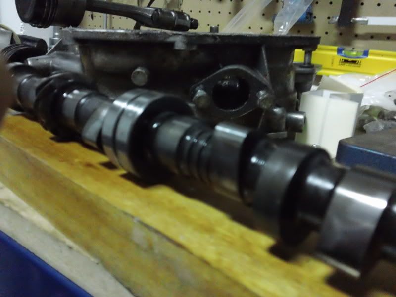

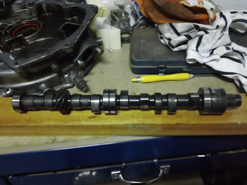

cam also seems fine to me, opinions welcome

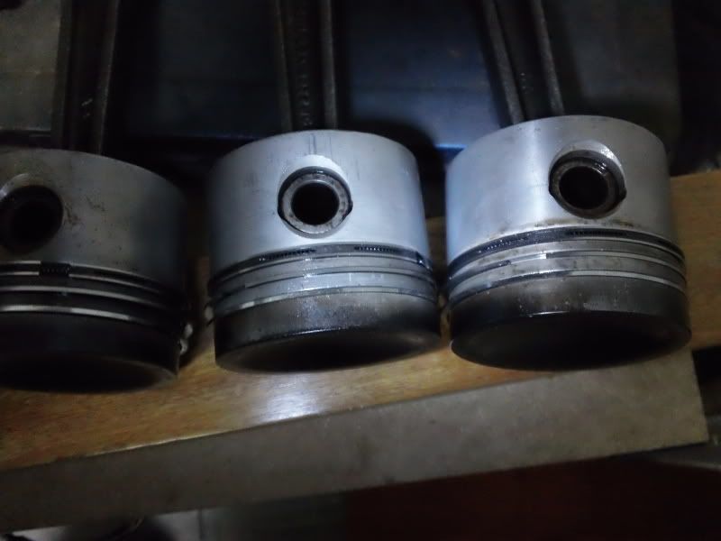

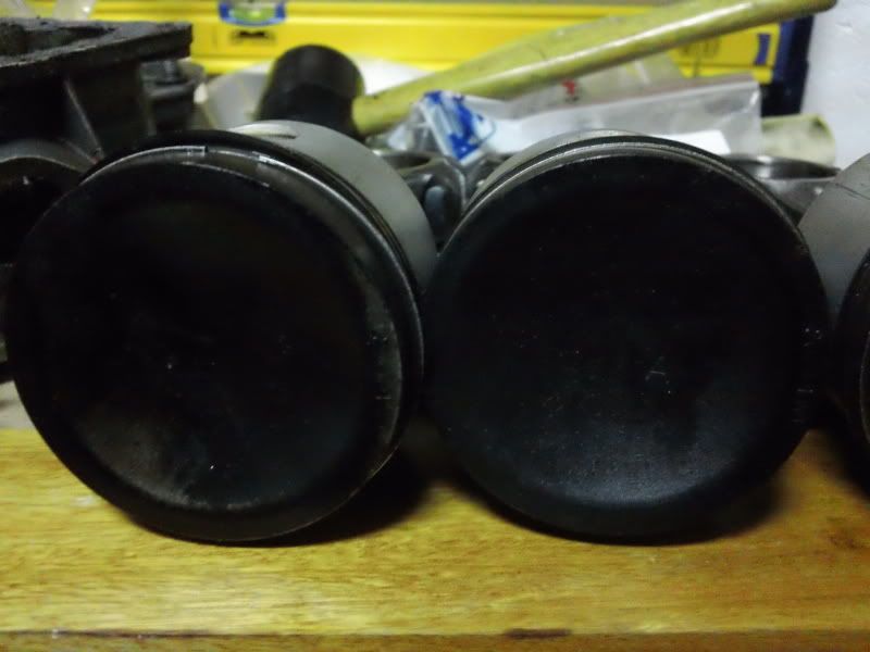

turbo pistons, everything looks normal

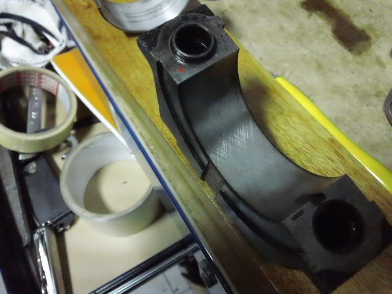

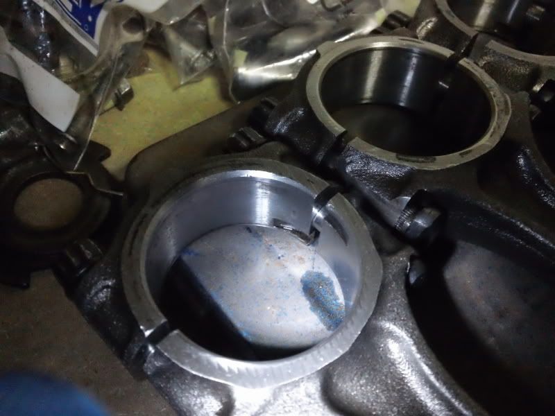

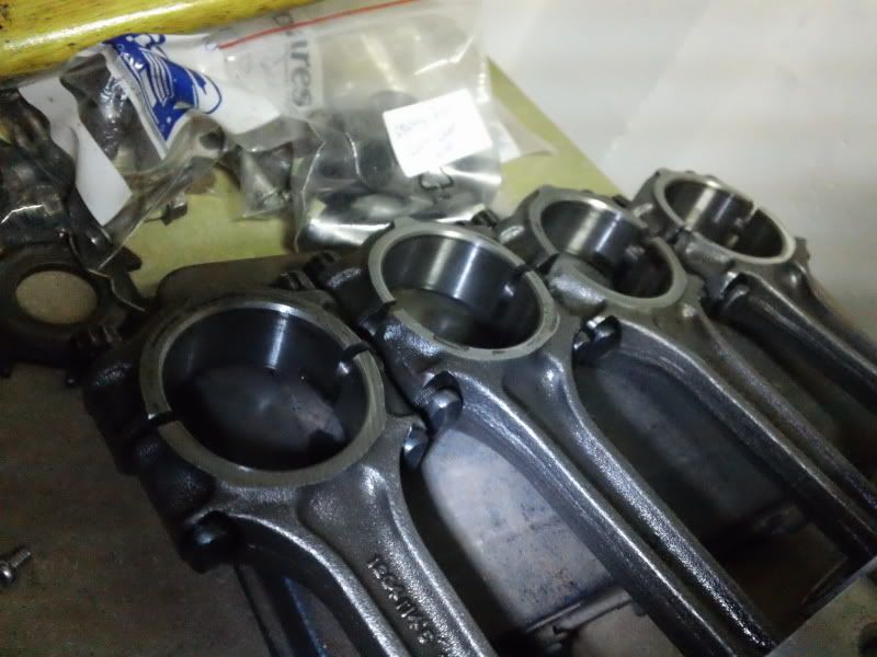

con rod end caps(aren't those slots suppose to align?) as none of mine do. pretty sure bill Solis mentions it in the DVD

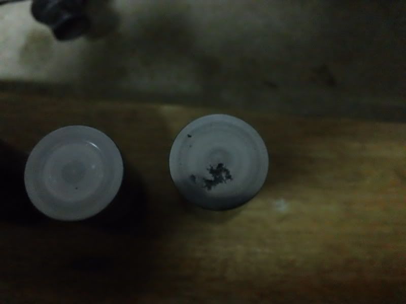

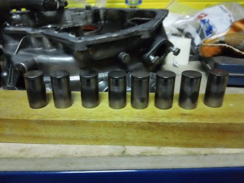

cam followers seems shot to me, especially the last one, its full of nicks and little craters on top as you can see in the pic

cant see any honing marks in the bores, but everything is perfectly smooth. can i get away with just getting new piston rings, or will the only way to say for sure be to measure it?

Take the block and crank to your local machine shop. They can meassure them for you and advise on regrinds/rebores. The bores look OK, so will probably just need honing to make sure the new rings seal.
Add to that new cam bearings/followers, shells, oil pump

What so wrong about those bearings? They look perfectly normal to me.
The rest I cannot comment on as your pictures are so awful. Macro setting next time?

as for measuring the crank, what exactly are the going to measure? and what are the measurement meant to be?
also aren't those tabs in the con rods suppose to line up?as they are completely opposite to each other as can be seen in the third con rod picture..
they are supposed to be opposite like that
They will measure the main and big end journals for wear and see if they need a grind or not. main journals are 2" as standard and the big ends are 1.75". grinds are done in 0.010"

ANd virtually everything looks totally normal there. And very little if anything wrong with those bearings.
Cam follower marks are certainly wear, but also very common. Replace the followers. No idea in camshaft condition as others say the pictures are terrible.

I'm with Veg, I'd happily put those bearings back in. Crank looks as I'd expect.

That bearing face on the cam looks like it has picked up a bit on the pulley end. What does the bearing look like?
