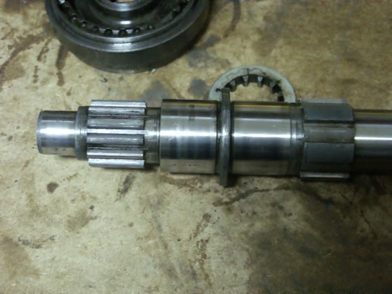

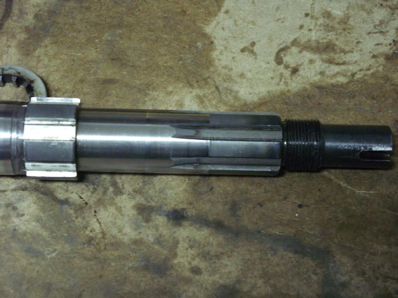

the lay shaft and main shaft do have some marks, which seem fine to me, but what do you guys think?
lay shaft

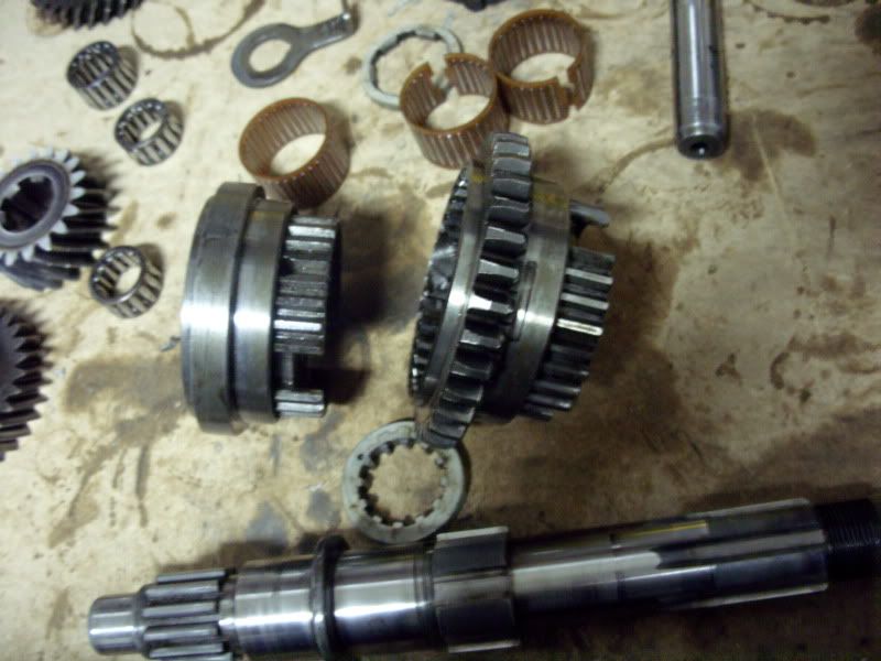

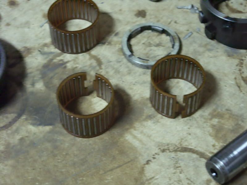

also two of the needle bearings look like this, split in the middle? they dont seem broken but i found it strange that they were split and the other one is a complete circle. is this right?
also, dump question but which of these synchro hubs is for 1/2 gear and which is for 3/4, i assume the larger one(the one on the right) is for 3/4 gear. is this correct?

yes they appear to be all servisable and in decent fettle *smiley*.............. just shows how regular oil and filter changes work ........i have stripped many a gearbox to find out all the lots goosed through tight previouse skimpy owners of the engine in the past

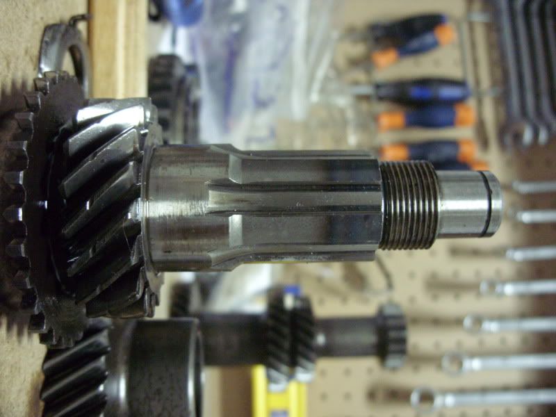

There are actually three bearings - two large ones in the main casing and the smaller one that supports the overhanging end of the input shaft and locates in the transfer housing. It's the one you would have taken off first (belongs on the very end of the shaft, right hand side of your third photo).
It is this one (only) that is a larger size for the turbo box (or more technically, the transfer housing that belongs with a turbo box).
The two bigger ones inside the main casing are the same for any 4 synchro boxes.
The bearing you missed is this one

i think i have figuered it out... the one in your link Rod S, is that the one that would be plastic with small rollers? that sits on the very to tip of picture 3, where the groove is?
Yes, if you intend to attach it to an engine.....
In your third photo is the bit of the mainshaft normally called the first (or 1st) motion shaft.
Once it's back in the gearbox with the big bearing I linked, the input (bottom drop) gear goes on, then the nut/locktab then, on that last remaining bit of plain shaft belongs the smaller "nose" or "support" bearing. You can see the circlip groove for holding it on in your photo.
What you actually fit is just the inner race and rollers of said bearing, the outer race is fitted to the transfer housing - have a look at your transfer housing and you will most likely see the old outer race of the old bearing.
I'll see if I've got a photo somewhere...
The one I added the link for is the one in the gearbox... the one (and the turbo alternative) that you linked to are the small one, plastic cage (normally) and small rollers.
The photos in Minispares catalogue are deceptive over the sizes.
