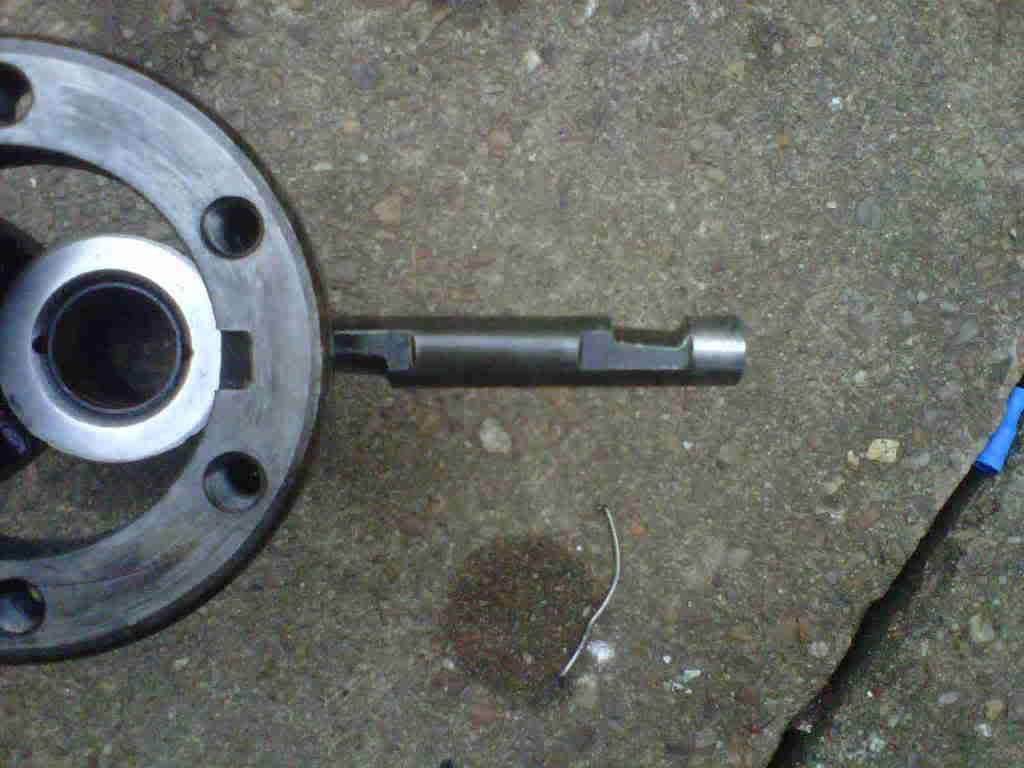

Ill post a pic up tonight of what happens when you put that sort of power through a standard diff, took about 300miles as it was about to shit its self lol

heres the very worn diff pin of mine.
