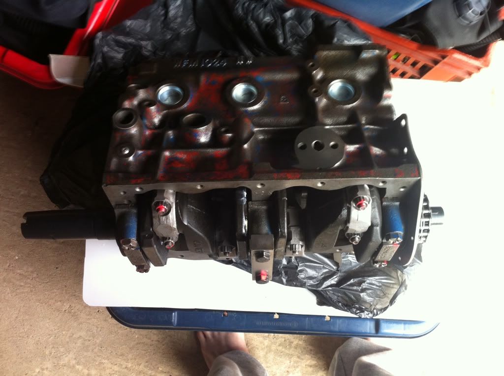

Right managed to get my engine back but without all my other bits ive brought, but not sure if its ok or not, here a quick video of it straight after we got it outside the unit it was built at:
http://i196.photobucket.com/albums/aa260/r...et/24df9385.mp4

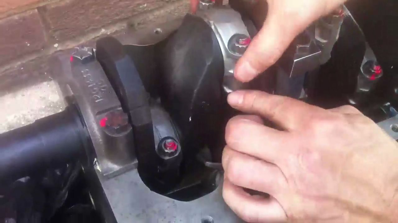

Correct me if im wrong but shouldnt the crack turn over By hand, and shouldnt all the bigends be the same. As 2 are solid and 2 are loose. We questioned it but he said itl be ok anf left it at that, i however am not convinced...
Any advice please?

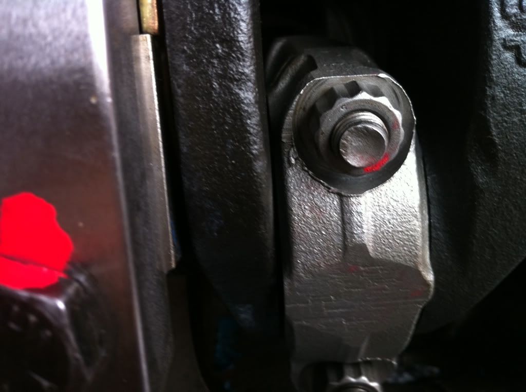

Also ive been charged for peened rods, not sure wgat they look like but to me these just look like theyve had a quick sand blasting to clean them up? What do peened rods look like.

Which rods are locked? could they be in 180 degrees out?
An engine that won't turn at all is not good, as a fresh build it will be tight, but shouldn't be locked.

Looks OK to me. The movement is side to side on the rod. As long as there is no up and down movement it is OK.
As for turning it, I would not expect to shift it by hand due to the friction of rings on the bores. You should be able to turn it easily with a spanner on the crank bolt, oil the rings first.

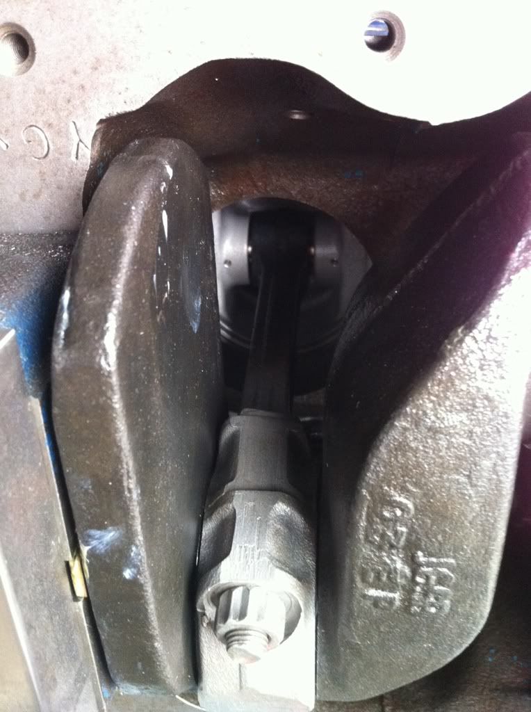

are the rods in the right way around, as they are offset?

Try a screwdriver in the end of the crank see if it will turn over.

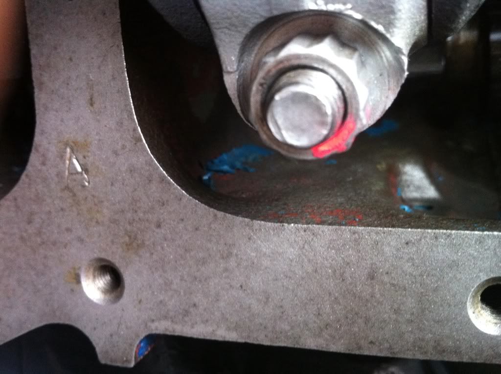

Right turned to over with the screwdriver method (well upgraded to a bigger spanner for more leverage) as i dont have the pulley bolt to hand. And managed to turn it a quarter o the way round, couldnt turn it anymore, thats wit my old man holding it and me giving the beans anf tring to spin it.
And on the penned rods... Do these loom penned to you as i would hae thought if it got rid of the rougher bits like these rough bits from machining? :
Heres what the inside of the block looks like (loose old paint ready to go round the engine when its run up):

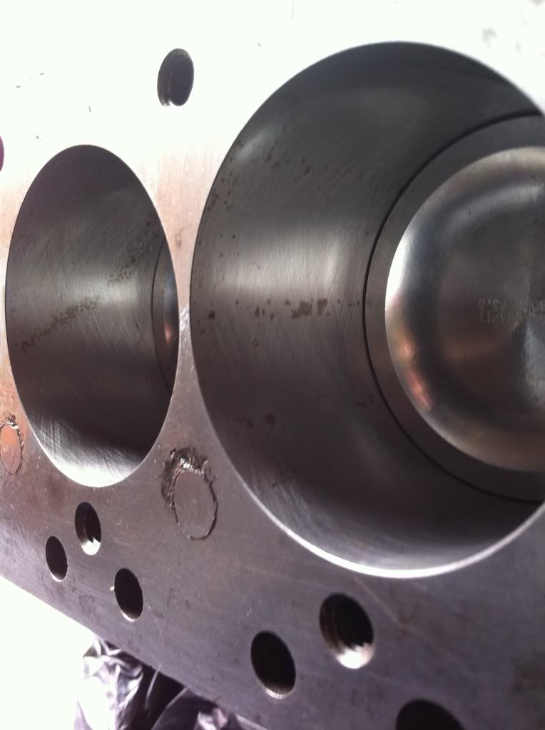

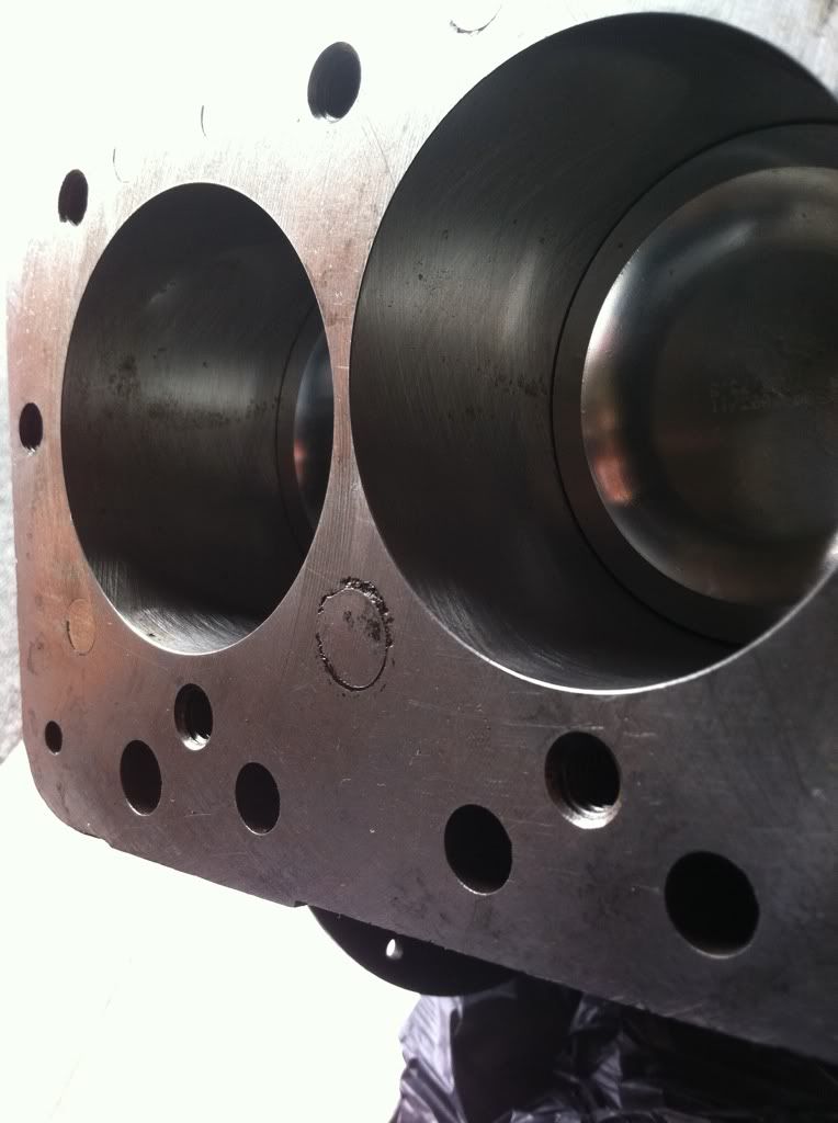

Very Slight corrosion in a few of the bored:
then a few metal filings and dirt here and there (bearing in mind i have ha this stored in my garage where no metal work is done and has been covered from when we picked it up from the unit in 3 heavy duty plastic bags on an empty shelf)

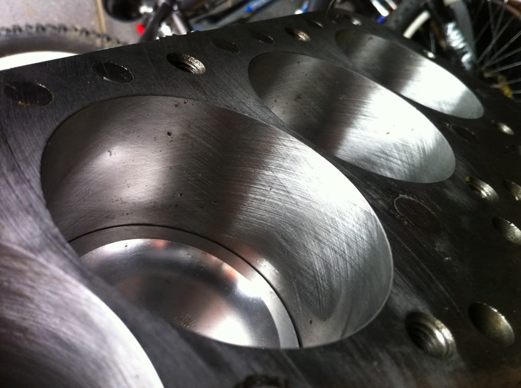

What have they done to the coolant ports in the head mating face? Attempted to dry deck it?

what have you paid £4k for??? is it my eyes or the picture, but that con rod doesn't look straight.

From what I can see I'd worry a bit more about it being built right rather than about a new set of core plugs to paint it properly...

Ap i blocked the waterways on the block under his guidance a long time before it was built, i asked wether to use brass but he said dont.
Why didn't you just tap them & screw in a plug ? Cheap & easy. :)

Dontknow mate i reallt dont theyre tapped with steel plus (cut off bolts)
