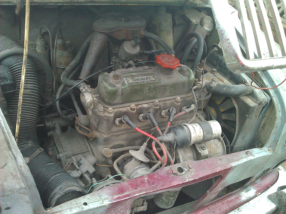

honet had the cooper 998 engine isnt it?
On 11th Mar, 2012 Amp said:
It would work, you'll have to set something up for the choke though
The choke is just below the throttle, you'd just need to find the range rover abutment plate.

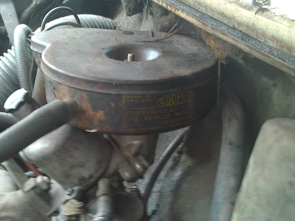

Not sure Joe, ours has a single HS2, an airbox with a cooper service sticker on, and we can't figure out the numbers on the head. It's remote change too.
