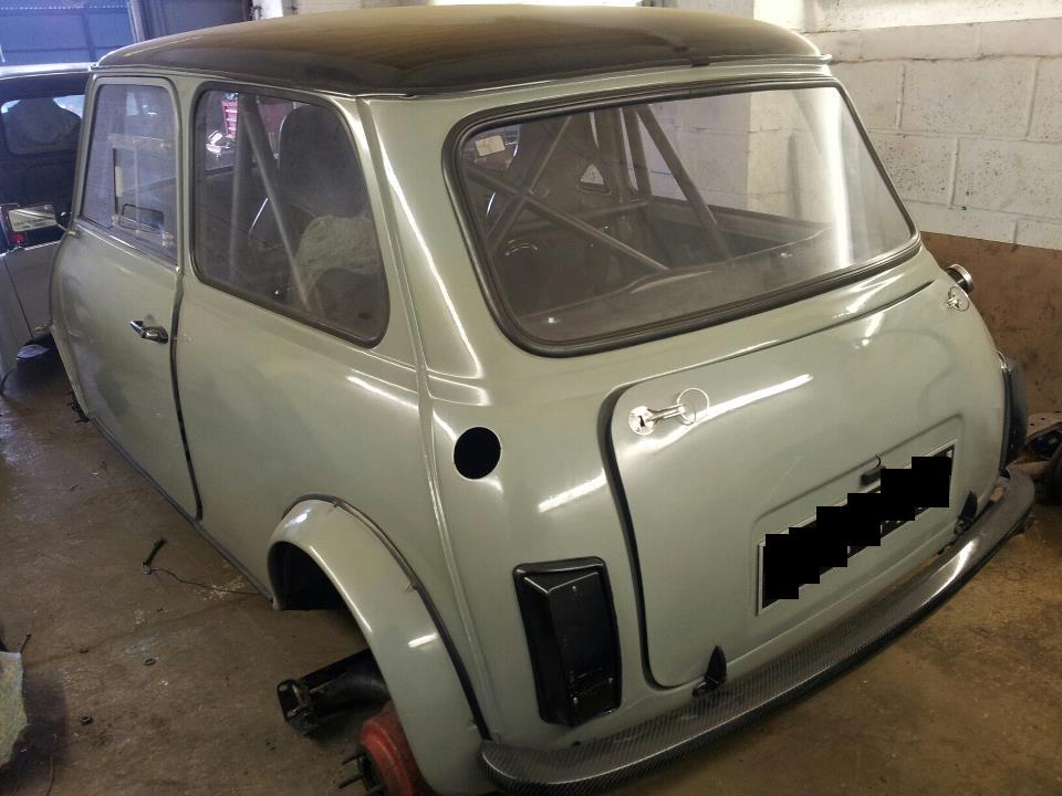

well most of you will know that this is MARKGTT,s old car there isnt much im doing to it to change looks wise. ive got some 10x6 special wheels to go on, other than that its going to more or less look the same.

Such a Pretty car! hope yours comes out just as good if not better ! :)

so ive took the rear subframe off as im fitting my rear beam im also running coilovers on the car.
also picked up some 4 pots from wales on monday along with some fibreglass seats for the car which weigh 2.5KG each *happy*
also test fitted my intercooler today as you can see in picture 4.
