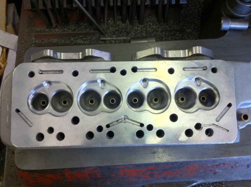

I have one. Not used it yet but it wasn't machined fully. To my standard it still requires a skim, port polish, the 11stud holes were only drilled 9/10 of the way and It. Weds a clean because theres chunks of ally inside it. Other than that it's good. Lol
i also have one and it needs a fair amount of work still on top of buying it

I have also have one from Webcon. They need a fair bit of work, and you should also budget for bigger stainless valves and suitable high quality springs.

ive been told that the ones of ebay are the pierce ones? and i did buy it from ebay. it was still a bargin at £900 (inc all taxes).
i will be swapping the springs from my other turbo head which were a kit with the phase 2 cam from AVR.
The work still needed in the head is as follows.
1. Skim £20
2. Chambers £?? (need polishing and smoothing out)
3. Port Polish £free if done by yourself
4. clean £free (if done yourself)
5. re-lap valves (to be on the safe side)
6. change valve springs
7. fully drill the 11 studs.
you dont have to buy the head with valves and springs and as such its cheaper. i did, because i am thinking of using them. i was told that people had used their heads with their valves and they assured me they are up to the job of using a turbo.
i would recommend getting one, as long as you consider the little list of jobs to do, which in all honesty isnt going to cost a lot providing you keep their valves and springs. or have a spare set to pop in?

For a Turbo motor you really need stainless steel valves 214N, or Soduim Filled exhausts valves at least. I sure the ones supplied are not 214N and only 33mm.
I bought a full set of valves 35.7mm x 29mm in 214N, for about £80. Then the seats and valves need cutting. £?
Other points to note:-
- The exhaust ports are too large and much bigger than the standard turbo or large bore gasket. Ive had to modify my gaskets to fit and grind out my manifold.
- The Exhaust valves are offset to allow bigger valves, you should really space your rockers to match. Ive got MED offset 1.5 Rockers, but you cant buy 1.3's.
- Spark plugs are only 8mm - ER8-eh, they are £10 each and foul up very easily due to temperature rating. You really need 7's, but are not available.
- Also Plugs dont pertrude into conbustion chamber promply unless you modify chambers with grinder.
- With AT Throttle bodies fitted its almost impossile to remove sparkplug no. 1 without removing the TB's. Ive had to buy a span-on semi long reach swivel socket that just does it after several attempts and still means removing air rams and filter backplate.

After dyno and road use with both Webbers 40'S and Fuel injection, I conclude this head is not really suitable for mild road or turbo use. At slow engine speed the cars lacks torque and only really comes on song from 3k. Same engine with 5 port shows better power until 3600rpm. The Injection makes a massive difference (can idle at 500rpm with 286), but still not a complete road package. But it sounds f**king brilliant.
I can't help but think the large ports and slow air speed, would not make good for a low CR turbo engine off boost.
This is why I have not continued with my 7 port turbo project and am considering the SC head instead. Don't get me wrong the pierce head as its place, but is more at home on the track or a wild road car.
