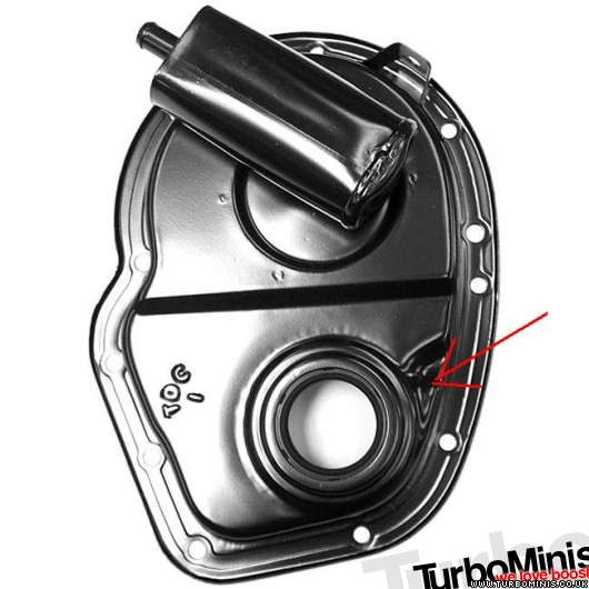

Thanks a lot Tom, Phil stated I need to remove the bump in the timing cover as well, does anyone have a pic of this, that I can visually see?
Bray this (from the inside) with a hammer so its flat

Excellent that is great, thanks again for the advise guys
