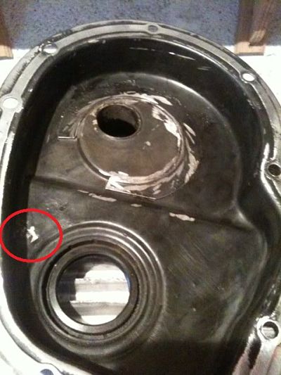

did you knock the lump out of the cover as the chain catches on it.

there's a small lump "circled in red" that needs knocking out as per the attachment.
this is what the internal of the cover should look like, i made the same mistake and the chain rubbed through in the end.

Sorry lee just read your comment lump ?? Im trying to picture it but il have to have a proper look at the weekend
You DO NOT need to remove the metal retainer type bit in the top of Lee's picture.
Eyup BTW.
lee.pb
1425 Posts
Member #: 9199
Lancashire
thought the ring had to be removed to allow clearance for the duplex chain *oh well*
if not why the "duck" have i gone it on two covers now eeeerrrrrrrrr dam mini forum *surprised*
Eyup BTW.
I've never removed it and not had any problems. You just have to bash the dimple out.

andy you DO have to remove the ring if its fitted with a rotorslide adjustable duplex,
a standard or lightend steel or cast duplex you you can leave it on

mines just a ligtend duplex but removed anyway.
my lightend duplex wore a hole in the cover after about 1000 miles as didnt knock out the lump *oh well*
