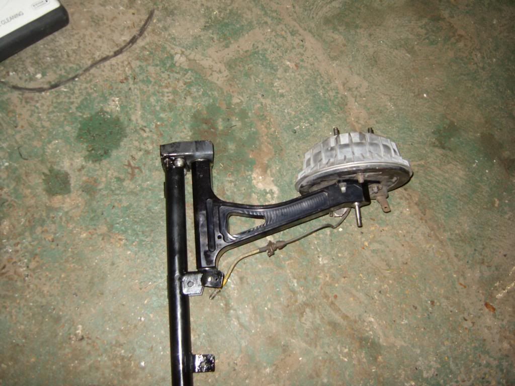

On 29th Sep, 2013 afrance2905 said:
mint have you got any pictures?
Not too much to look at really.

they do look very nice,well anything cnc machined looks nice really
and that is the main reason certain companies can actualy sell shit, it looks great. It doesn't mean it is any good.
