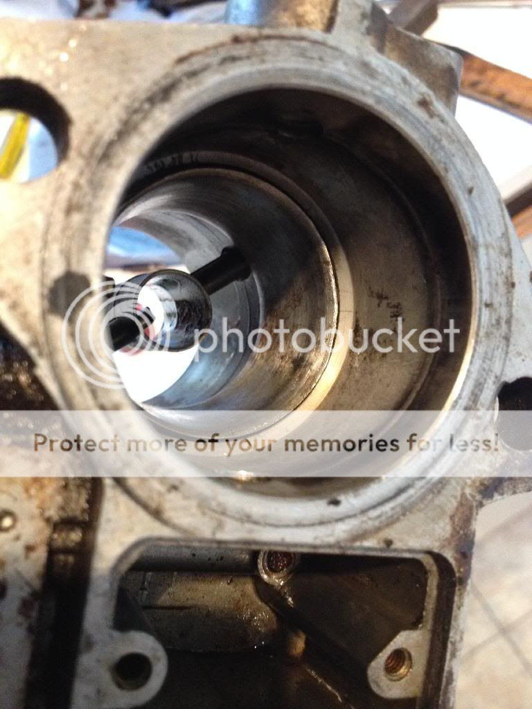

I started stripping the carb down this last week as it was sat for about 9 years this is how dirty I found it:
Pair of calipers showed that it is a weber 48 DCOE:
More stripping pictures:
I managed to borrow an ultra sonic cleaner today and sooo got the weber and its bits in there, as its one designed for jewellery its not hugely strong so I'll be leaving it all in a bath of petrol for like a week afterwards:
After like 42 minutes:
After the first bath of 69 minutes:
Small bits in for the second bath:
All clean:
And the big bits put in for the third bath:
That's literally cleaning as I type this :)

So the cleaning processes completed and this is how the weber came out:
So the weber is SOO much better however its not perfectly clean just yet so its currently sat in a box of petrol like so:
I've since found the carb is choked down to 40mm, I'm actually glad because I have been told the 48 size will be way to big for my application.

You measured the wrong end of the Weber, check the butterfly end, I reckon its a 45
I second this as you can also see it says 45doce on the top plate.

I measured both it is 48 on each, its been stamped on the top twice as well, will give it another go when its out of the petrol :)

So finally got the weber finished and back together:
