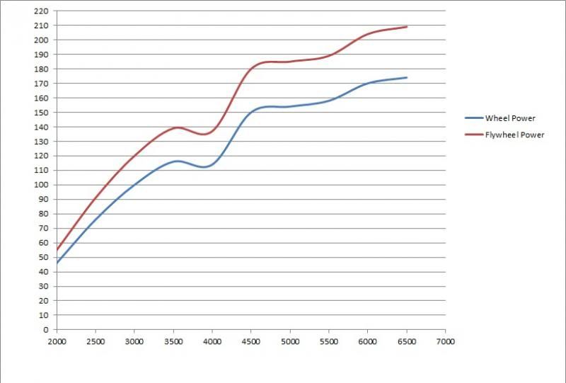

went for another tune up today with larger injectors, I'm only running 1 bar boost (14 psi) with Benross special head on a 1380 bottom end, Help from Neil fromPolestar with his ecu and specialist components Injection, cossie 4x4 intercooler, the blower comes in nice and early and produced 208 @ 6500 rpm.
Very happy, kept the boost low due to oil getting a bit warm, will improve on this and try for more another time, there was deco more to come from the engine.

Powergraph
http://s1336.photobucket.com/user/timinitu...449832.jpg.html

Just managed to get a look at the sheet there is alot of power loss through the box is it still ok?

yes box is all good, fresh build

Do the lynx rollers measure transmission losses Tim or is it just a best guess at 20%?

Awesome result there Tim.
If you copy the IMG code off photobucket and paste it in a trend it should show up without having to click on it.
Remember to delete all the other text apart from the text between the two IMG tags, these need to be left in too.
Just a bit of fun with excel.
