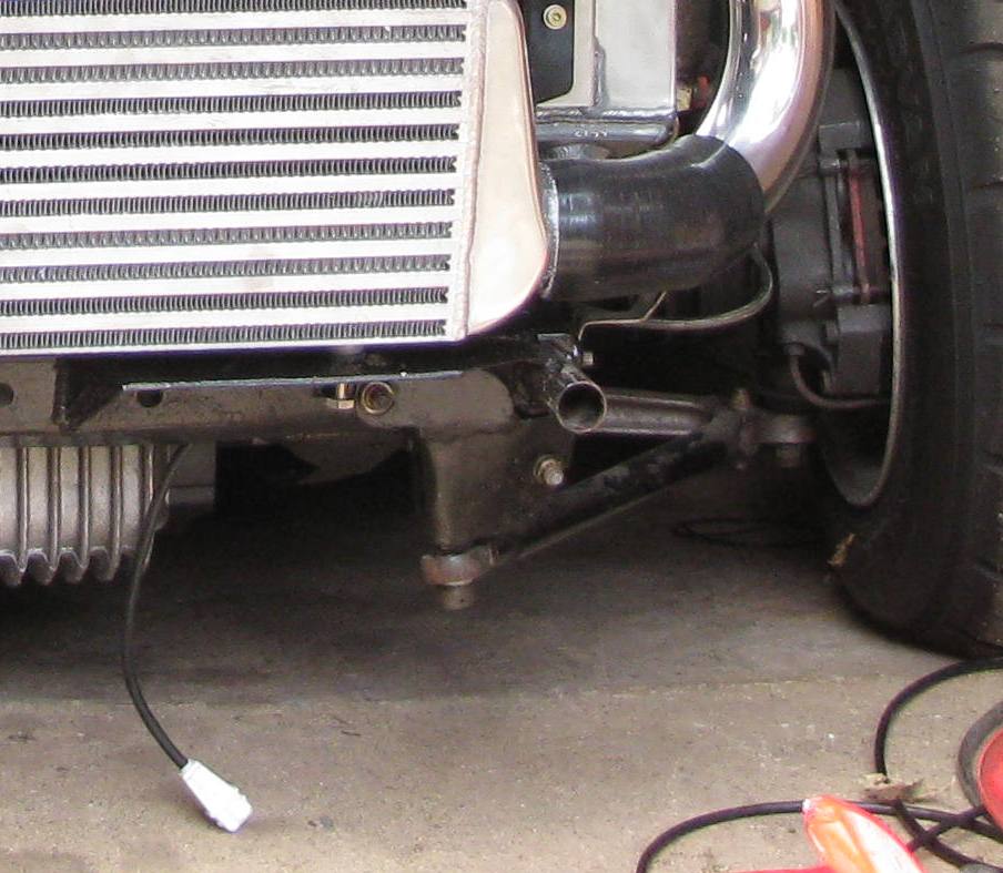

Is this any use:

It is indeed, thanks Paul. What do you use your car for? Do you think it helped?

15th Jan, 2014 at 05:03:55pm
It was a Miglia built by Endaf and co. that passed through without use. Didn't get to drive it. Saul Bellow - "A great deal of intelligence can be invested in ignorance when the need for illusion is deep."
