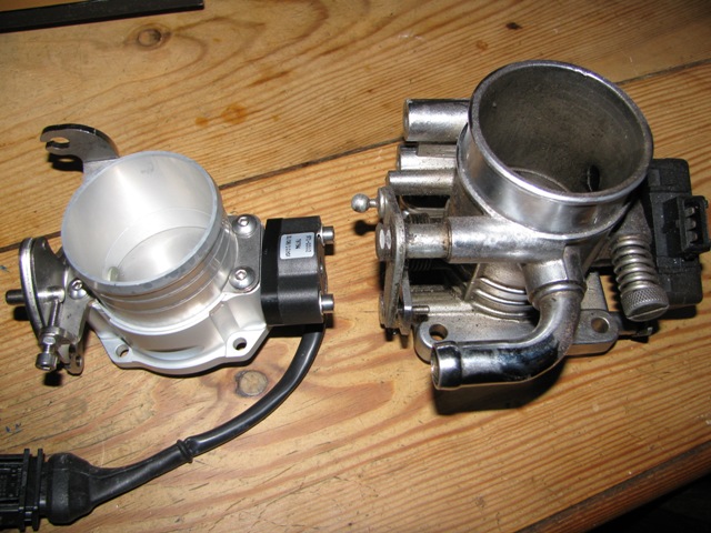

Previously, I've used a Ford unit and an AT Power 50mm billet jobbie:
The Ford unit is actually about 57mm but has a progressive linkage so is quite useable on the road. The AT is nice and compact but very expensive and a bit of an on/off switch.
For the next project the Ford unit is too big and the AT is about £220 so looking for something a bit cheaper.
