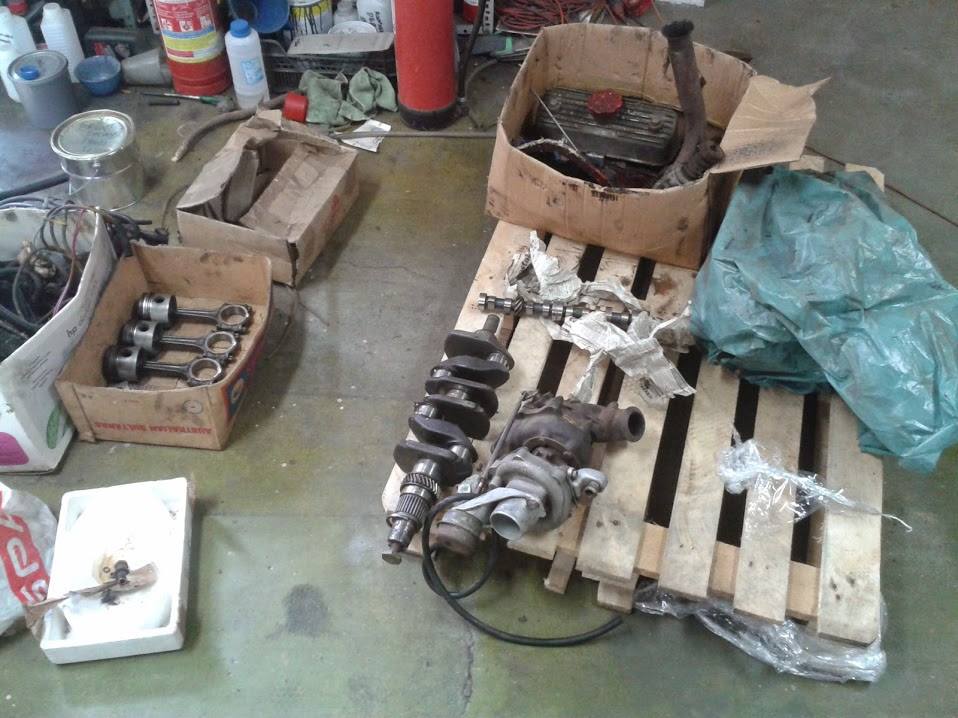

My name is Adam and I've been repairing and rebuilding Mini's for few years now. Usually they were brought to their original or sometimes slightly upgraded condition, but time has come to tackle something more challenging. I hope that with your help and advice I'll be able to build some fast but reliable Minis.
I did quite a lot of research now so instead of just saying "hello" I'm starting this thread to share my thougths.
GOAL: around 120BHP 1,3 A+ engine that can be used as a daily driver.
I'm starting with what you can see in the pictures. It's a Metro turbo engine that has been put in to pieces and kept that way on a shelf for few years now. It seems like there is all there, but some parts will surely need replacing or refurbishment.
The idea is to use GT1549 turbo(easily available unlike the gt1548, faster spool up then on the GT17 or T3, hope to be able to run around 15psi) on a custom manifold to keep the body mods to minumum, reworked head (36mm inlet valves, enlarged chambers to reduce CR), 266 cam (or something simular). I think that this along some other smaller or bigger mods should be enough to get the power output I'm aiming for.
On the other side of the equation we've got the reliability part and probably most of the questions I will have will be about what to do to make it all run smoothly and safely.
So is the mission possible?

Sounds very realistic and should be easily achievable.
Czesc,
Don't forget the wideband O2 sensor. That is as essential as anything in your build...

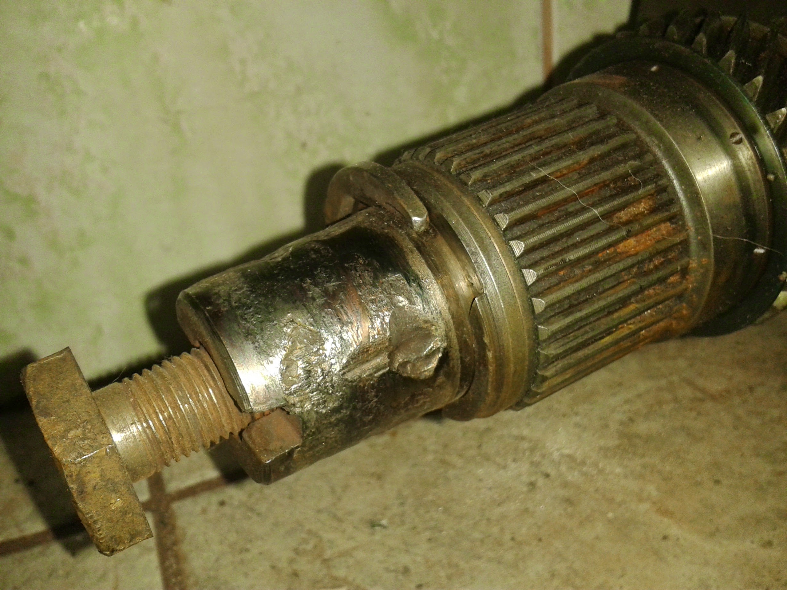

MMM, thats a bit fucked

yup. however I found a company here in Poland that claims they can deal with it. They will need a flywheel to sort out cone dimensions, but since they estimated the cost at around 25-30quid I might give it a try.
agree with colin its well goosed, if they can do it for that money it will be worth it

Question
could you not fill it with weld and re machine it?

I guess that's what the machine shop will do more or less.
