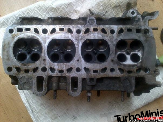

A plus Block
K1100LT Head
K1100LT Head mounted on the block using the three original studs that are correctly located
Next jobs are to beadblast,weld and machine

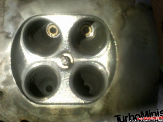

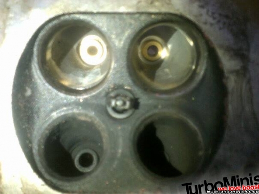

Decoking the head today :)
Heres a start............
Going to be getting deep inside those ports too :)

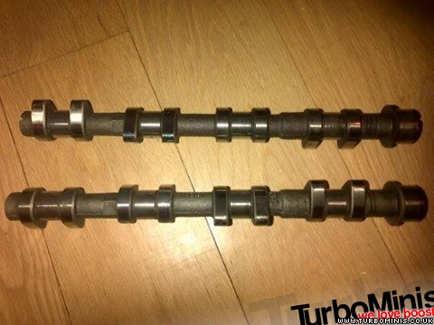

I just had the cams out de greasing them and I cant remember which one is inlet and which one is exhaust? numbers are 461368 on both and 495 on one and 489 on the other.
PS Also been playing with these, cant wait to start putting it all together :)
wayne miller
211 Posts
Member #: 10890
Twin Cam Turbo Build In Progress Rothwell, Northants
I've just found out that the 461368 means that they're the 256 degree LT cams. Which is good as that's what I bought them as :) still don't know which is exhaust or inlet :(
have you googled the numbers?, i know when i had mine i found a web site with loads of info, part numbers, cam timings it was a bike site of course

Carl S
1927 Posts
Member #: 1761
Stalker
The service manual tells you which cam is which. I believe there are some indication bands on one or the other.

Thanks Carl,
The service manual states on page 29:
Camshaft identification.
Inlet: Groove after the thrust bearing
Exhaust: No groove
Just what I needed :)
that info is for the high lift RS cams..Can't for the life of me remember which is which for the LT cams, but as Carls said, its in the 'correct' workshop manual. Use the right manual to determine the inlet and exhaust, but in the grand scheme it doesn't matter which goes where as you'll time them up anyway.
The K1100 LT and 'RS' low lift cams are the same. K100 4v and K1200 are usually the saught after high lift 'RS' cams. The easiest way to determine which you have is measure the lobe lift. 'LT' cams are around 7.5mm lift while the 'RS' cams are around 8.9mm lift
as for which is which, i don't remember myself :) i'd be looking in the book or figuring it out with the location slots on the rear of the cams

It was the LT Service manual that I downloaded which states that 461368 are the 256 degree LT cams. The service manual also states that these cams are also identifiable by the extra groove after the thrust bearing. All's good now :)

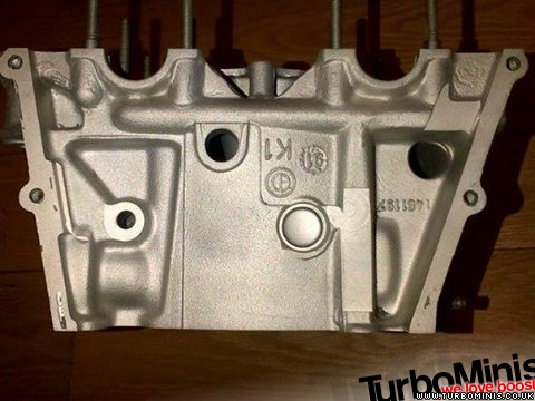

wayne miller
211 Posts
Member #: 10890

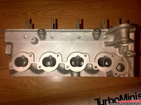

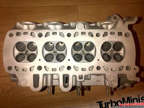

Head all cleaned up and bead blasted ready to go for welding and machining now. One thing that has done me head in (Pardon the pun) and that's the exhaust studs. Who ever removed the exhaust simply cut through the studs, they'd rusted like hell and now Im struggling to get them out too. It looks like its going to the machine shop as it is and the studs can be removed there :)
Its looking a lot better than it did when I first got it :)

Get them to take them out when its hot for welding.. easy!
don't forget to weld up the hole the rod cam out of. Or you will have oil and water mixing

On 7th Oct, 2014 Sprocket said:
LT cams.......
Inlet side : three grooves after thrust bearing
Exhaust side: two grooves after thrust bearing
