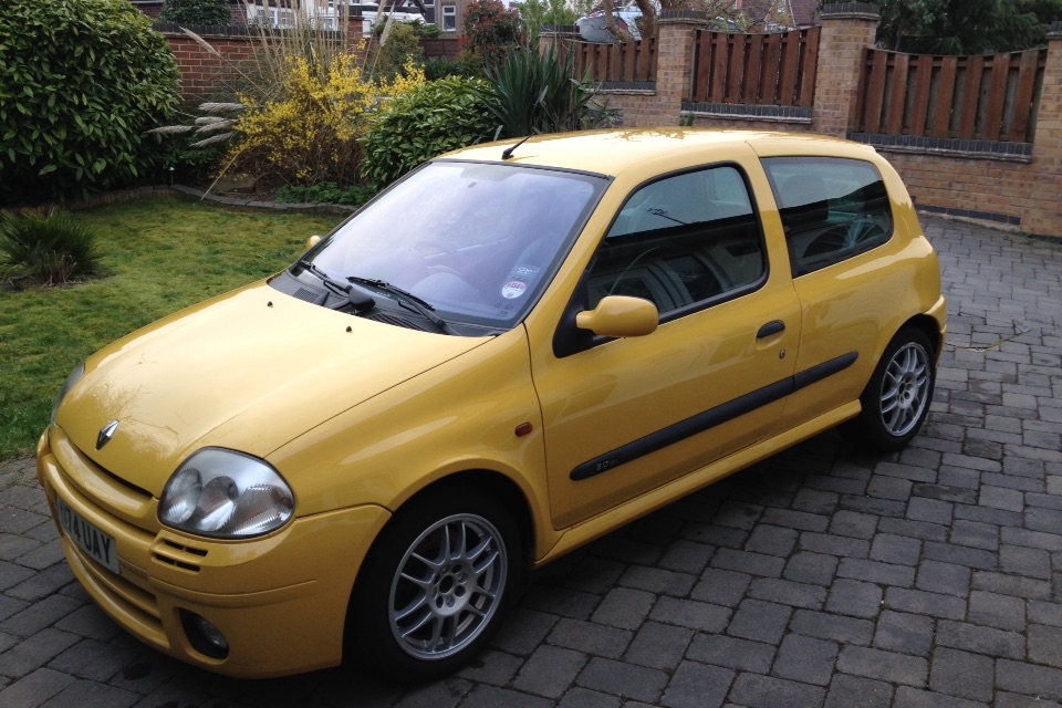

![]() 216 Posts Member #: 9845 Senior Member Staffordshire |
25th Feb, 2015 at 08:54:12pm
Here's my old ph1 172.. 998 t2 ongoing project. |
