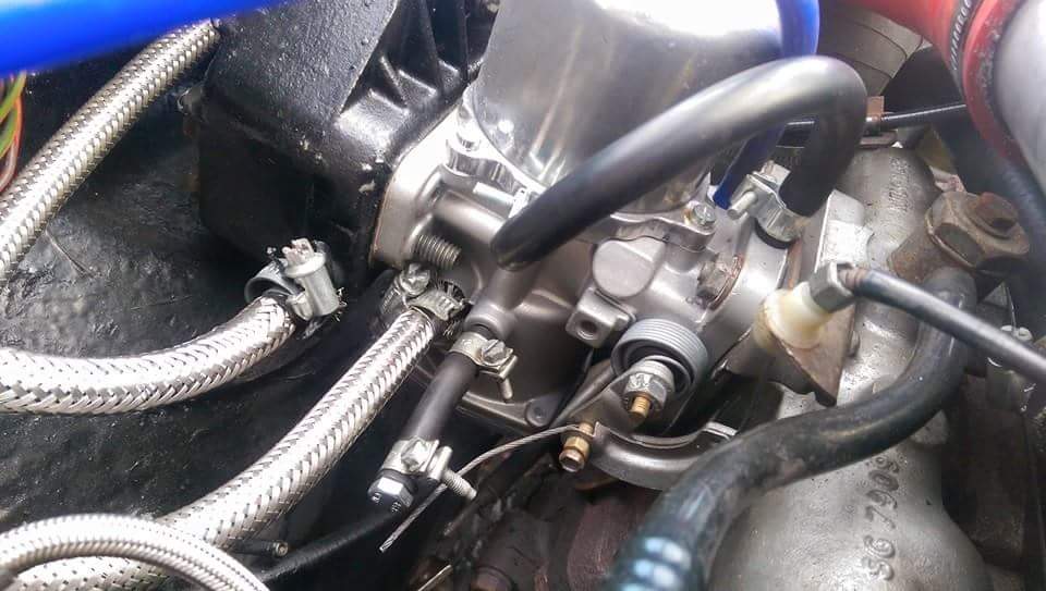

Post a photo of your carb plumbing. Check the part throttle pipe for splits.

Here's the plumbing for the carb

Pluming looks right. If it was working before then it probably is.
The lean off pipe looks in good nick, but worth checking for splits.
