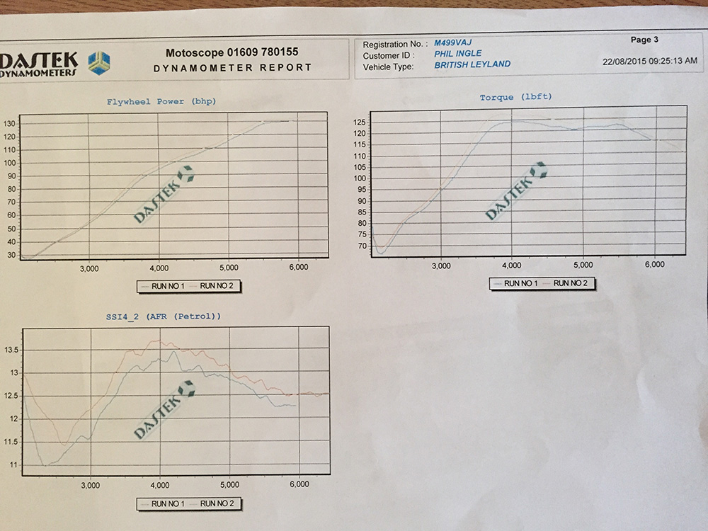

Iv got an old rr print out of mine just before I stripped it its rich up till 3000rpm, Iv not touched carb so will be same fuelling but maybe standard cam didn't mind as much so didn't Bogg down??

Have you got a wideband fitted? 13.5 afr at 4000rpm, when presumably you had full boost, is too lean.
no not got one yet, yes on full boost at 3000rpm with gt1752,I drove it like that all last summer, didn't have it on rollers till just before I had taken it off the road,was just a power run to compare to now after rebuild.
