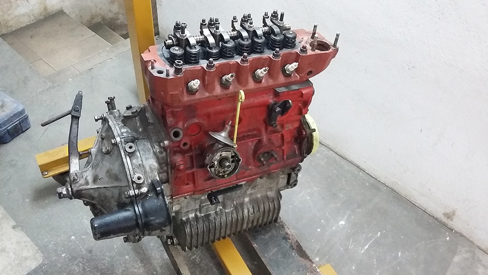

By the way, this is the 1275cc I have sitting in my garage. What about its cylinder head ? Is it a good one ? From the little research I've done its a 12G940. |
![]() 1030 Posts Member #: 1291 Post Whore Suffolk / Birmingham |
3rd Oct, 2016 at 08:52:59pm
A 12g940 is the standard 1275cc head. Its a good Base for a modified head if that's what you mean. Nothing special as standard tho.

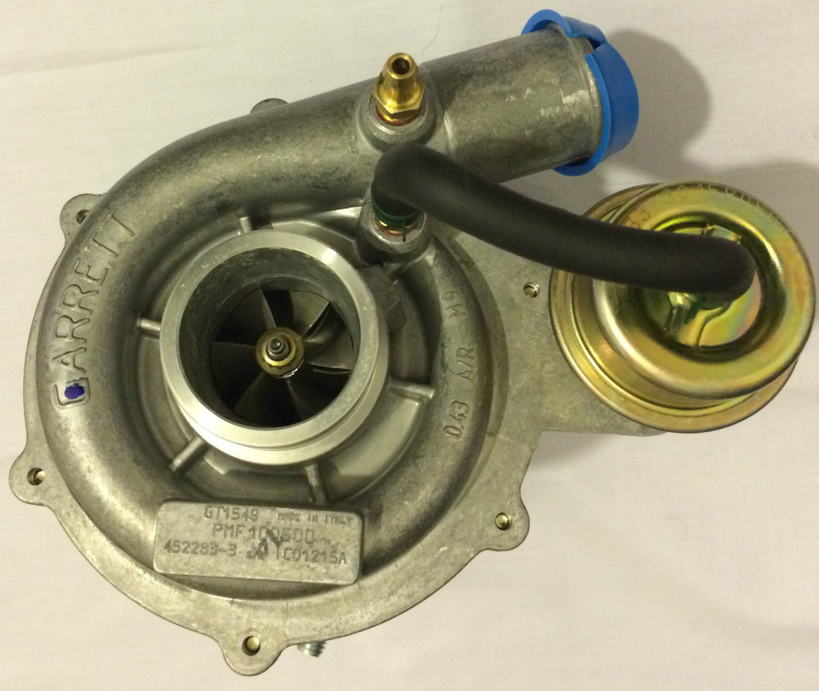

There are lots of choices for a decent turbo for a 998. A GT1548 worked well on mine. I don't know what a GT1549 is from, but it sounds too big.
307 Posts Member #: 11231 Senior Member |
4th Oct, 2016 at 08:33:42am
The GT1549 is from the Rover 25 SDI, 45SDI, 75SDI and MG ZR 2.0Turbo Diesel |

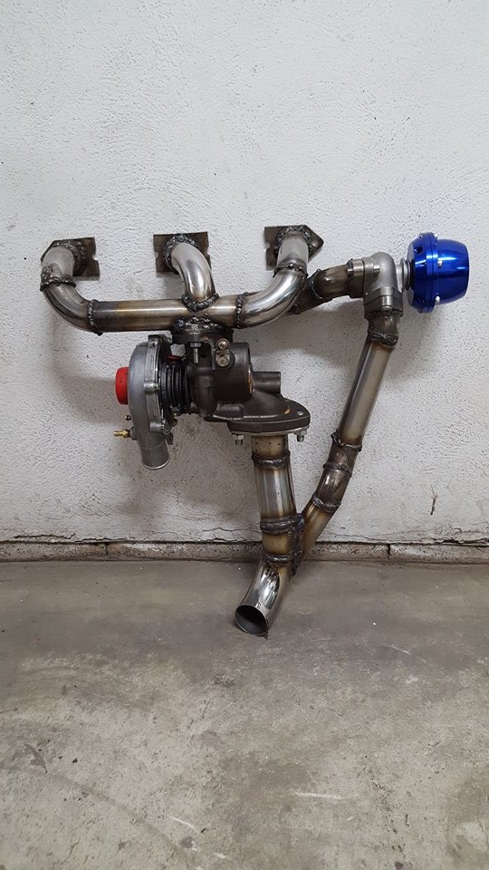

4th Oct, 2016 at 05:26:19pm
What have you done about the internal wastegate?
4th Oct, 2016 at 05:28:24pm
I fabricated a rod to keep it closed. |

On a side note, the 2.0L SDI was a 134hp deisel on a standard boost of 15psi, so should boost better than it is on a 1.0L engine On 26th Oct, 2004 TurboDave16v said:

4th Oct, 2016 at 08:10:19pm
actually Sprocket, to fit perfectly in front of the cross member I had to cut the lever arm of the internal wastegate and weld it on the opposite side. |
4th Oct, 2016 at 08:12:06pm
To understand, the rod I've fitted is pushing the lever away from the compressor, which is equivalent to pulling it towards the compressor in the original configuration |
