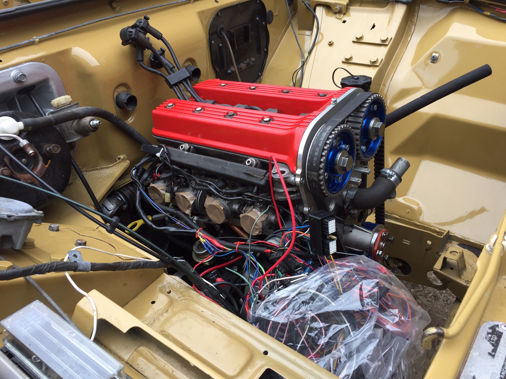

I am building this
Into this

HA! excelent!
not seen a K in a marina yet, good stuff.
Welcome

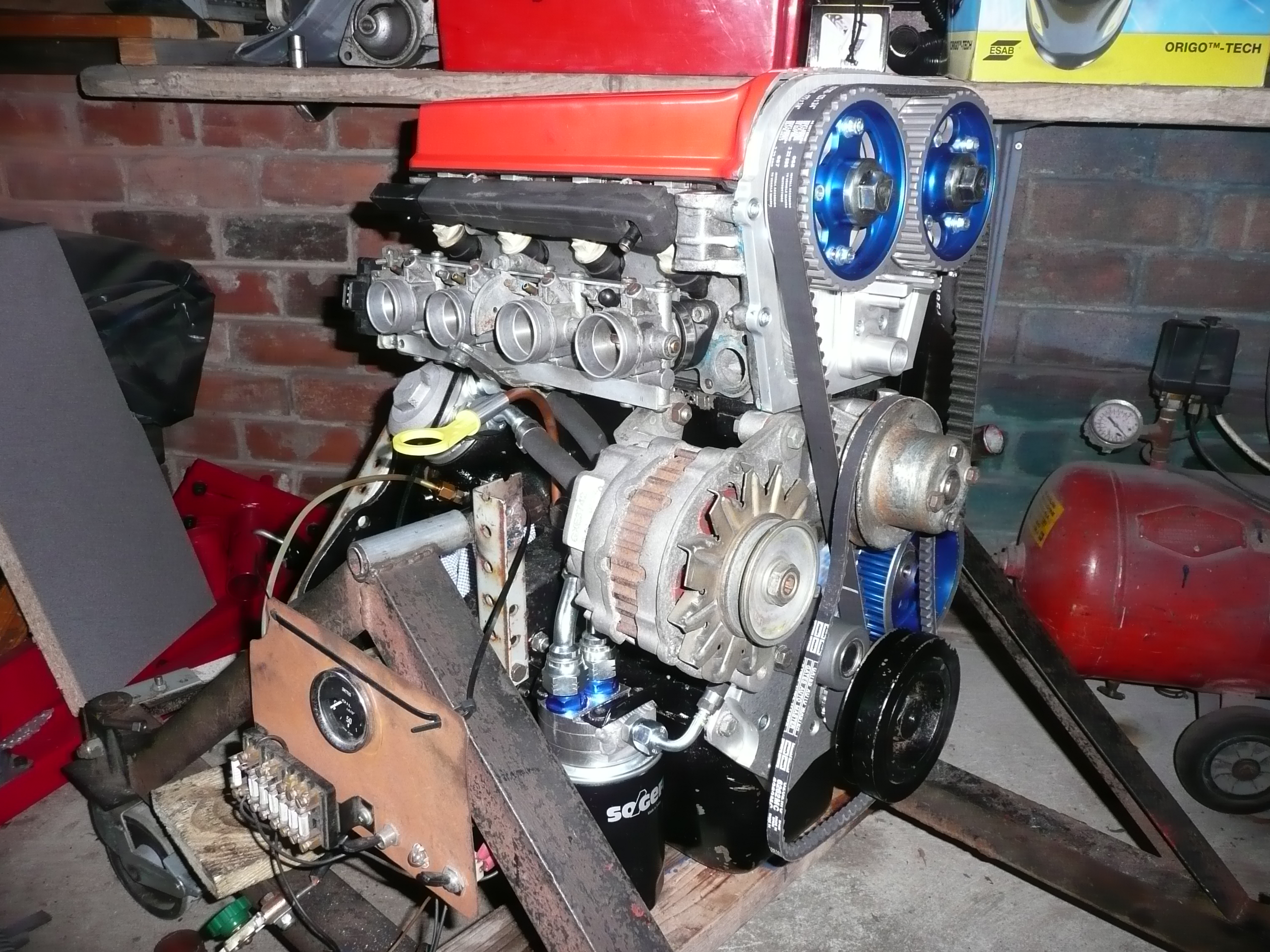

I thought that I would leave an update on progress.
Here’s the engine running on the test bed.
https://m.youtube.com/watch?v=C8c3E9xvibA

That’s come on well

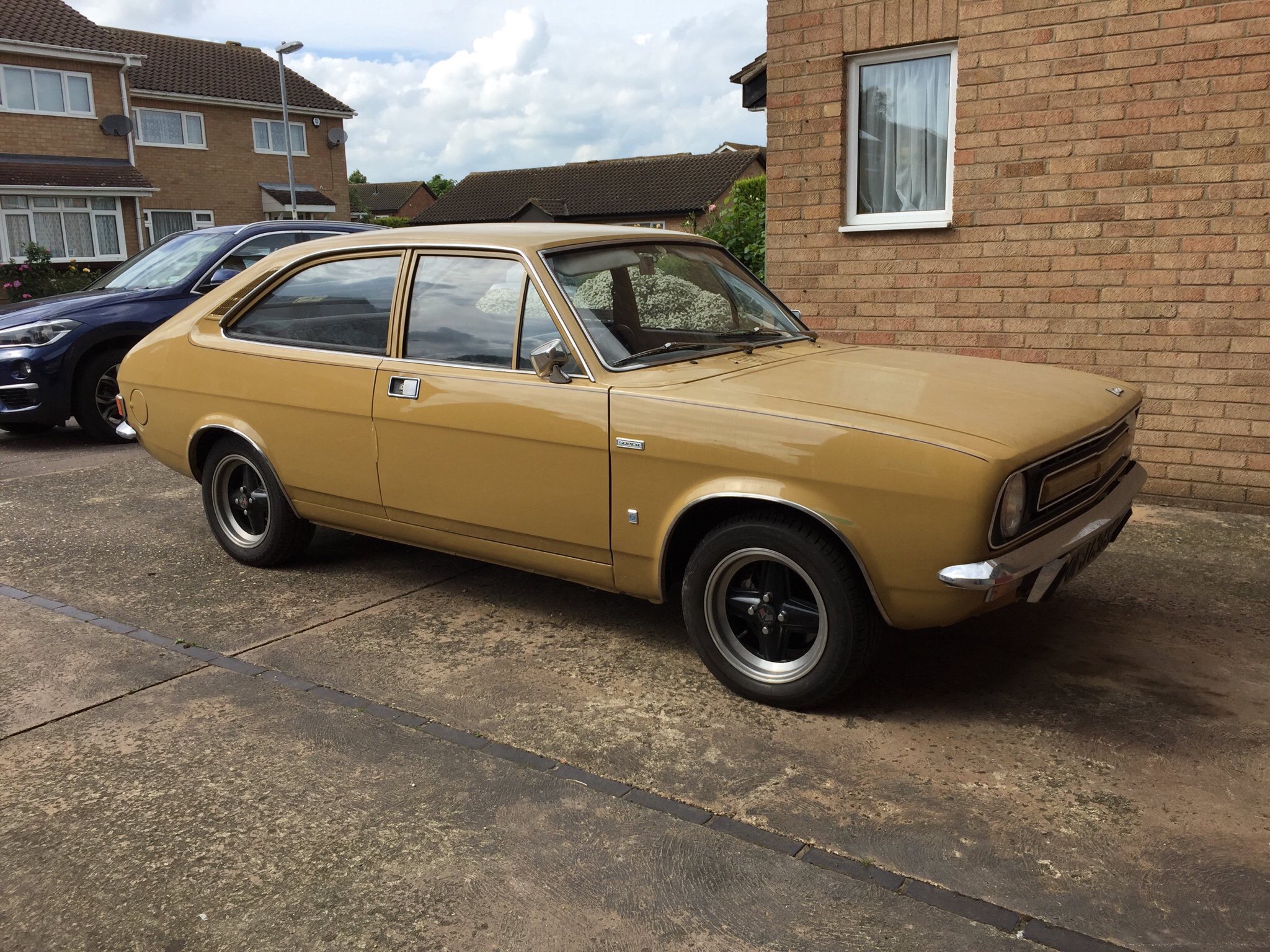

That's a nice 70s color, excellent.

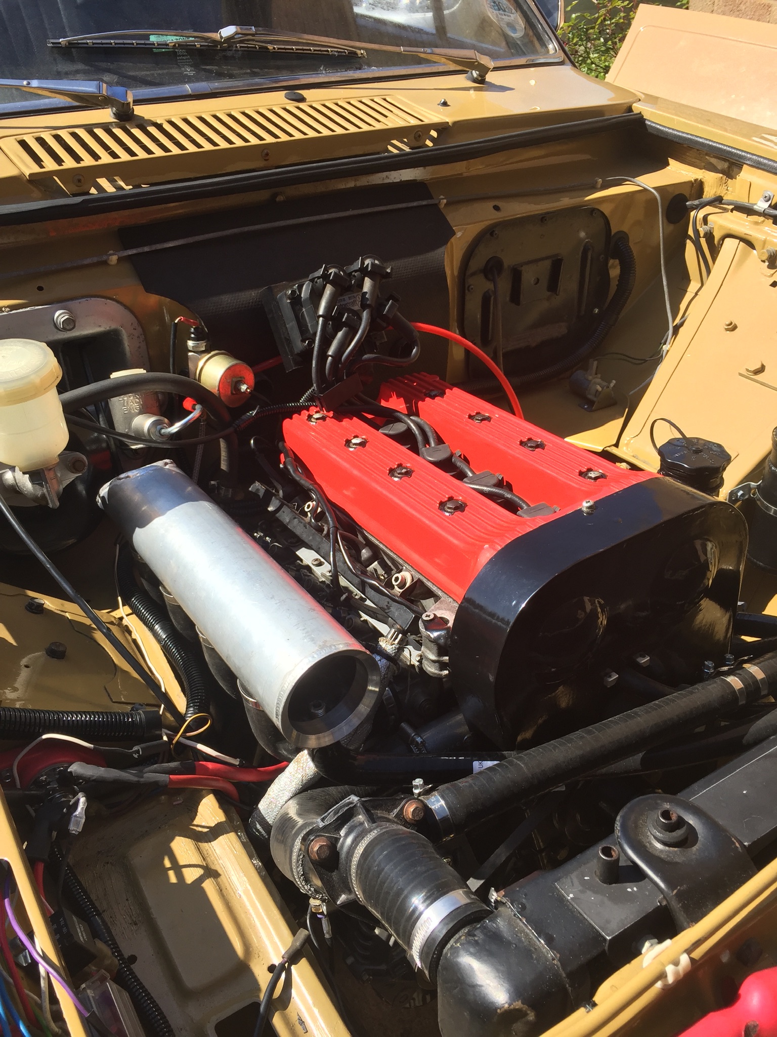

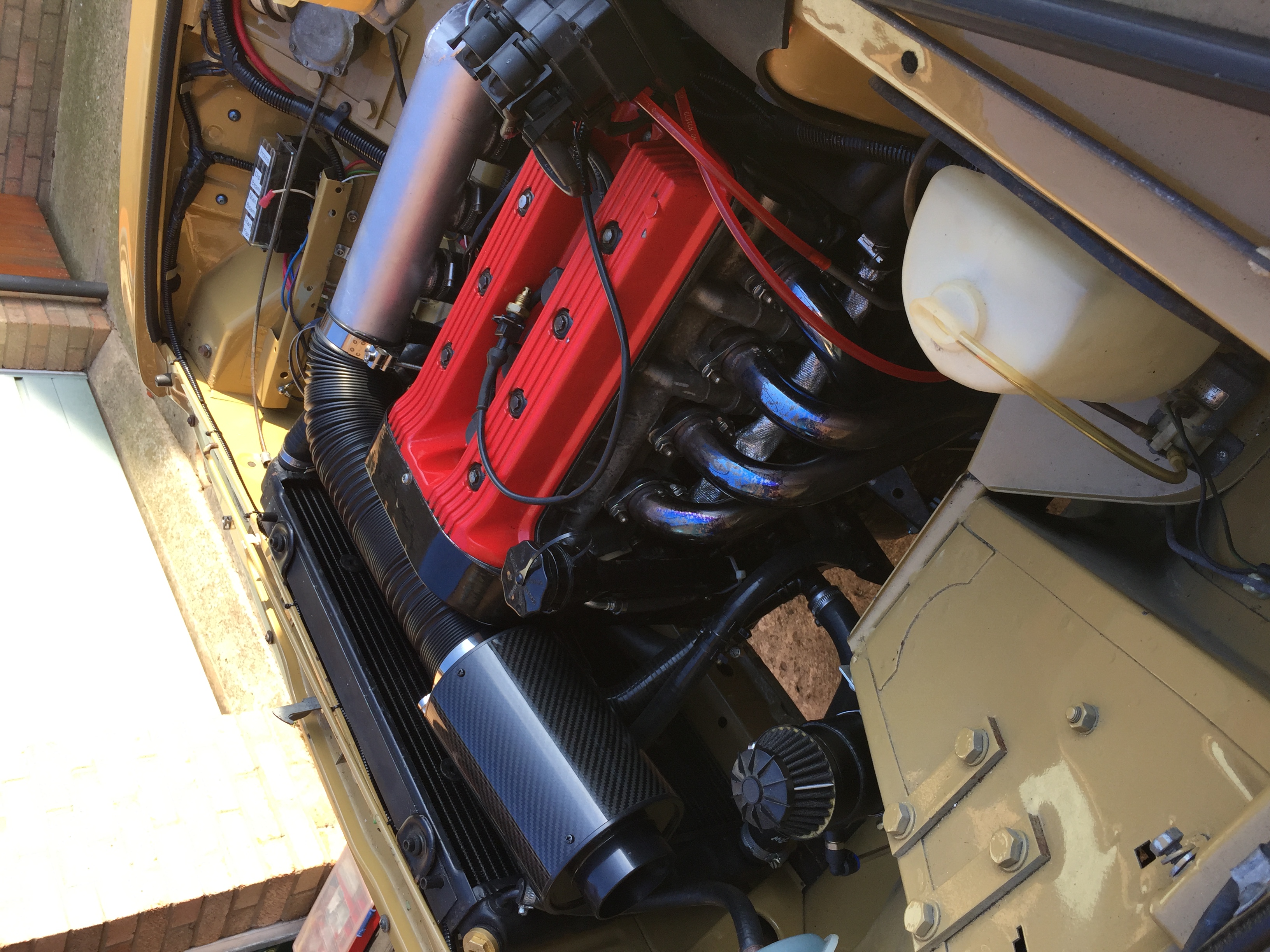

Finally, here we are. It was in and ready to go last August, but a stray washer jumped the inlet camshaft by four teeth, so before turning a wheel, the engine needed a strip and rebuild. No valve to piston contact damage thankfully.
Installation pics and video of first start, last weekend. There’s a hell of an echo from the inlet plenum, that has now gone with the inlet air filter and inlet tract.
https://youtu.be/g6eysXChcPA
