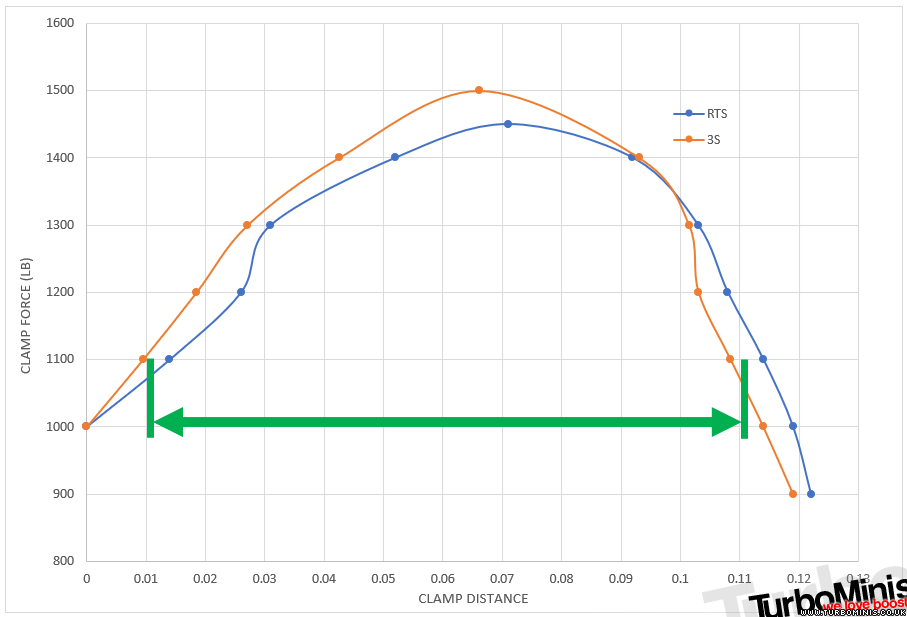

I have indeed played with the post height. This pic shows the clamp force. The curve goes from the left to the right for the spring relaxing - that is to say a worn clutch would be on the right, a new clutch on the left. I adjusted my posts so at .280" thick, it'll be at the left green marker, and as it wears, clamp force increases, then decreases. I could instead have set it up to be at the peak at .280", but as you can see, it'd fall off the peak clamp quickly...
It really is interesting how close the RTS and 3S clutches are!!!

In my analysis, I didn’t assume spring was offering highest force when spring was flat; in fact I didn’t look at the spring. I supported the verto drive plate on my press, upside down, at the six locations of the bolt heads, representative of real-life.
I then pressed down on the back plate (simulating the clutch plate), measuring the force, and the distance (over the average of three points) to get a force/displacement reading between the face at the six mounting points where the main drive plate contacts the flywheel. That then allows me to machine the flywheel post heights to the exact height that I want (knowing the compressed clutch plate thickness).
Actually, I should add that I started by fully compressing, past the peak (spring past flat) and then retracting the ram, so the force is measured that way. The results you get doing it this way are lower, but fully representative. That’s why the data above starts at a set point (spring over centre) and comes back to zero (although I stopped at 900lb).
I did not standardize around the spring flatness, I didn’t even think to look at it. But after it was finally built; I realised that the spring(s) was actually perfectly flat, meaning peak force is when the spring is about .060” below flat.

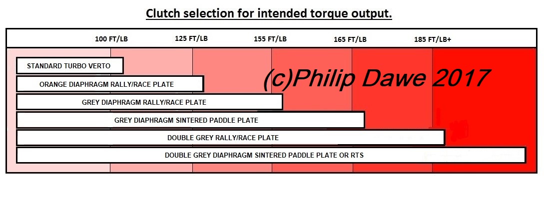

Great stuff Dave, thanks for sharing. While we're on the subject of clutches I knocked this up a while ago & would appreciate peoples thoughts on accuracy ......

I feel like tge “new” turbo verto units are probably on a par with the orange; maybe 120lb ft
Aside from that, add a disclaimer that it’s a guide, and assuming new clutch components.

Cheers for the feedback Dave. So aside from what you said above, the rest looks in the "ballpark" to you?
