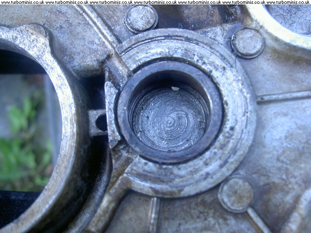

what you need to do is remove the old bearing in the gearbox then remove the inner race from the clutch cover
the easy way was i drilled mine 4mm then used a punch! to remove the race out
then tapped it M5 fitted 2 M5 button heads with cut short so as not to interfere with the new bearing been fitted
and stud locked these into position and then ground the heads down a little so as not to foul the fly wheel
see the pic below this shows some grub screws on the picture i used button heads M5
to fit TIMKIN roller set ONLY:- BELOW
NOTE: the timkin idler gear does not use thrust washers
right then get the idler gear by measuring equidistant between the gearbox and cover! get your measurement and then bearing fit high strength retainer into the gearbox SIDE ONLY! fit the bearing correctley as above!
leave to set overnight it should be a nice fit bearing into the clutch cover side only as the gearbox side is now FIXED!
i for got to mention the correct tapping size fro M5 is 4.2mm but been in ally i said 4mm makes a touch more thread for you which is needed!
please use say .....2mm drill for a pilot hole before you use the 4mm one
makes it more accurate *wink*
the idea came from a discussion we had and TURBO DAVE! came up with but ..............
i found button heads fastners to be just right for the job to clear the fly wheel backplate and lock up solid flat with the cover and become oil tight................i ground he heads down nearly to the btm of the hex part on them where the allen key fits! once theywere fitted and locktighted in.
a nice little trick! by turbo dave! & adapted a touch by me
hope this helps you!

I have to say i've always used the heat it up and tap it on the back trick and it works everytime. Haynes got this bit right :)

The transfer case i'm currently using still won't release the bearing when heated to 200 degrees, hence why i heat it to insert and remove the bearing.
Conversly, the 1st motion bearing on the other hand has to be inserted with bearing fit, as it's too loose for my liking!
I just have two small holes that i fill with epoxy resin - easilly removed when needed.
some casings the race comes out easily!
But most dont!*evil*
this is one method which gets results evertime*wink*

I put a long bolt in the bearing bore, then a large washer around the blot threads and weld the washer to the bearing race. Let it cool, fit the bolt shank to a vise, tap the cover once and out it comes.

i to use the same method as vegard only coz we have a similar toolin work just did mine yesterday i heated the casing with a heat gun first.

Just tried this steve :)
But this bearings wont come out *frown*
Ive heated it up also... give it a good wack.. she dont wanna come out and play...
Anything else i can try.. bearin in mind i dont have the tools some of u have...
Cheers :)

You have removed the retainer ring haven't you?

Errm, you on about this..
http://www.turbominis.co.uk/_photos/random...os/718/4118.jpg
Anyway, this is what im trying to get out.
It's not coming out ?
Cheers..

Used this method today, popped straight out, cheers Steve
