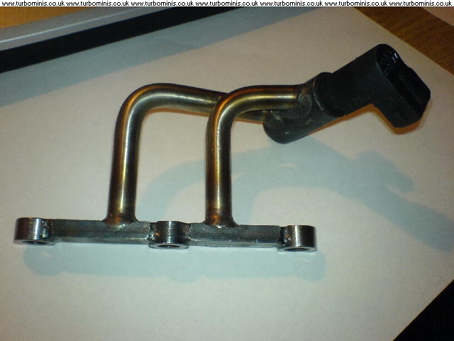

I know a few of you are very keen to hear of any progress on the sensor brackets I keep threatening to make to accompany these pulleys.
So here are some prototype pictures. There are a few mods to be made to this bracket before it is ready for production but I thought this might whet some appetites..........
Good work, Tom.
Having made my own a couple of weeks ago, I suggest that you check that the fan belt does not foul it like mine did!

Looks great Tom, def put me down for one when they are in production.

Cool Tom, nice looking bracket!
Please put me down for one.

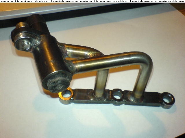

Mk 2 of the crank sensor bracket-
Now has mount to secure sensor, altered strut locations for better clearance, and cranked baseplate to fit timing cover better.

Hoping they will be ready for general sale in the next 2 or 3 weeks. Need to get the parts together (such as longer bolts, etc) to go with them.
very neat job tom!
I can't take much of the credit really, these have been made by the Spannerbitch-Racing stig, my tame fabricator/machinist mate, never to be seen without a welding mask or a pint of cutting oil......
The same guy who machines the pulleys.
