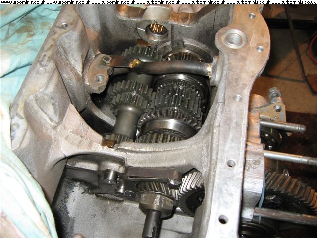

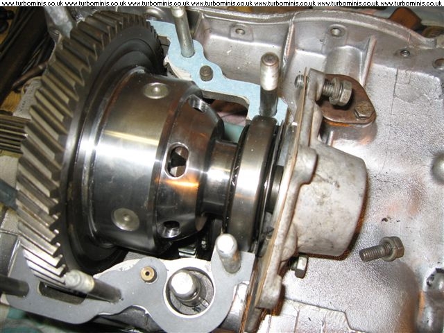

Just fitted one this weekend:
Minispares that is!
WITH, a Clubman gearset:
